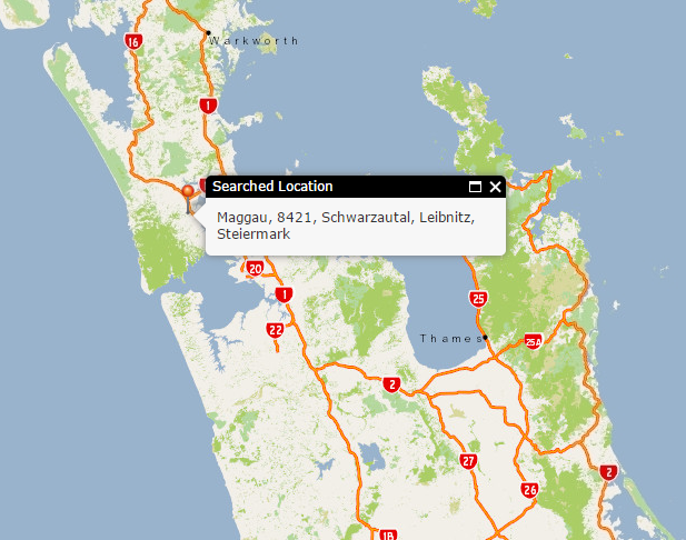

Hi there,  I have been trialing the AGOL Near Me widget with a non-web mercator basemap (New Zealand Transverse Mercator), and finding that the addresses returned when you click on the map are incorrect.  It appears that it is taking the NZTM coordinates and assuming they are Web Mercator.
This is the result when clicking the NZTM map.  Coordinates are: 1,743,724.0702, 5,919,606.5081:
Point clicked in New Zealand with incorrect address

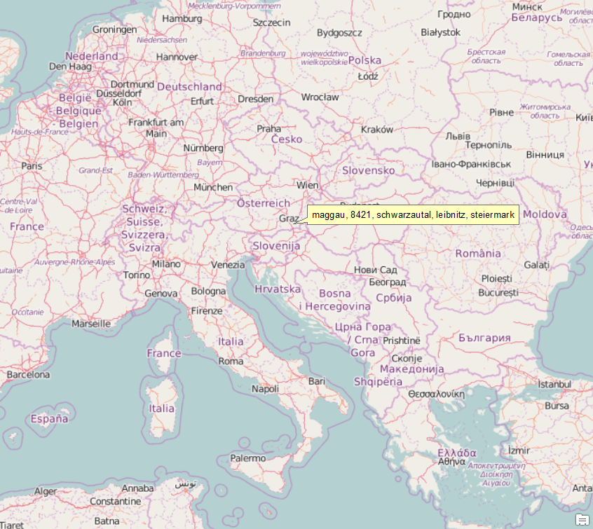

This is the actual location of that address
The same address geocoded
