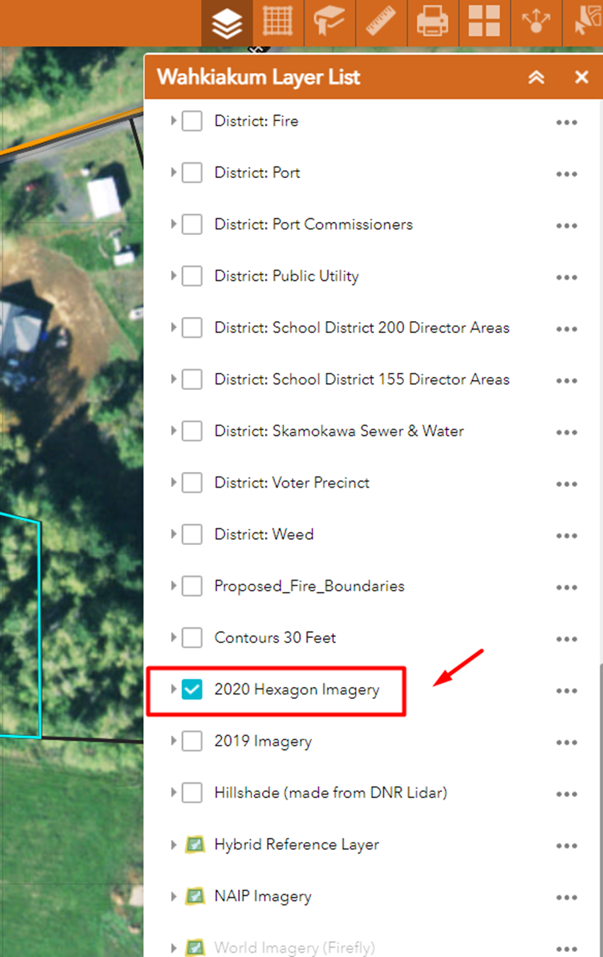

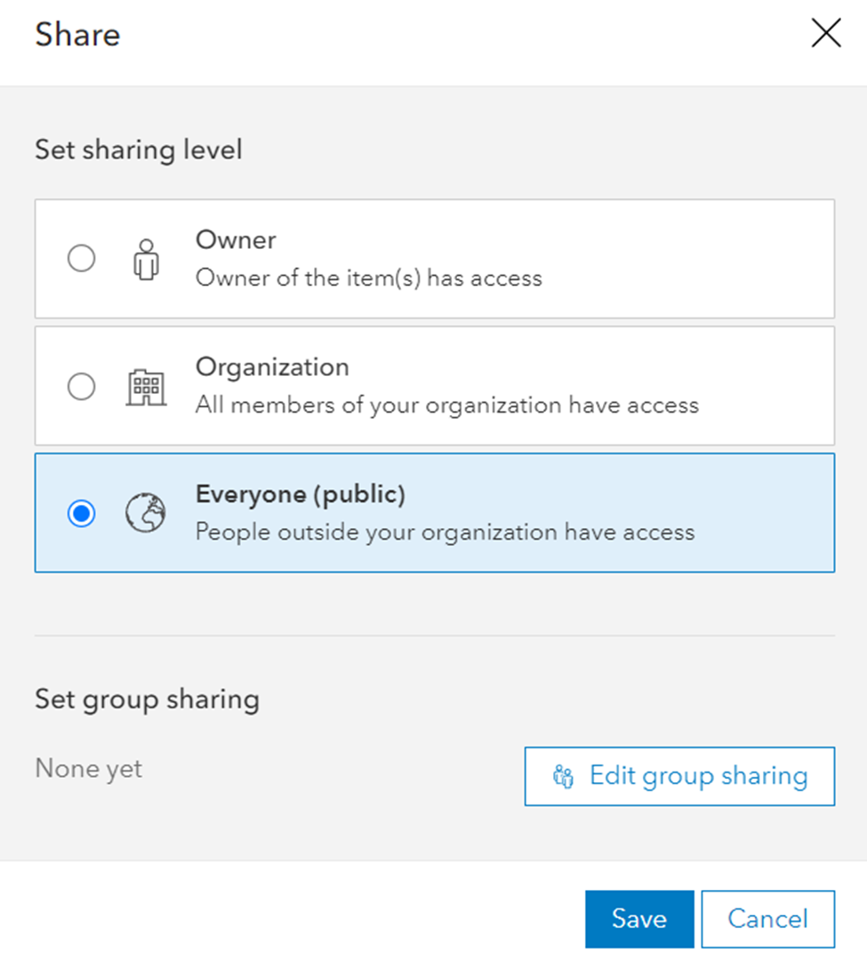

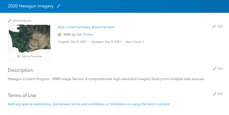

 I added Hexagon Imagery Service to web app builder using the add data,URL, WMS, token tool. I shared the layer with everyone. The imagery is working great, I have it turned on by default when the web app loads. It is at the bottom of my layer list and is called 2020 Hexagon Imagery.

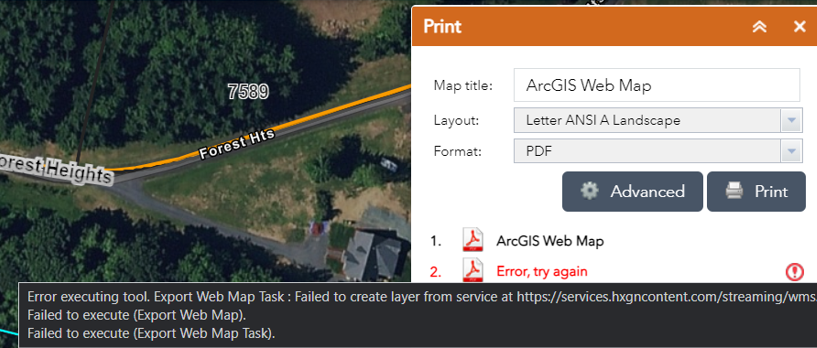

Problem: Recently, when trying to use the print widget with the imagery turned on the print widget shows this error:
Error executing tool. Export Web map Task: Failed to create layer from service at https://services.hxgncontent.com/streaming/wms.
Failed to execute (Export Web Map).
Failed to execute (Export Web Map Task).
When I turn off the 2020 Hexagon Imagery layer and use the print widget it create the pdf without any issues.

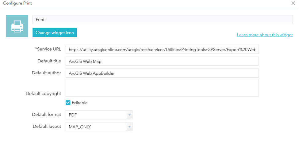

Here is a screenshot of my printer widget settings, I haven't modified any of them:
This is the full service URL:
https://utility.arcgisonline.com/arcgis/rest/services/Utilities/PrintingTools/GPServer/Export%20Web%...

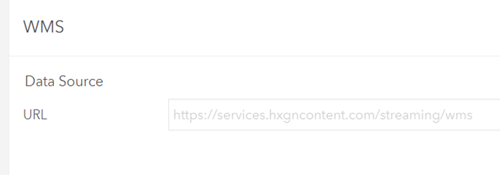

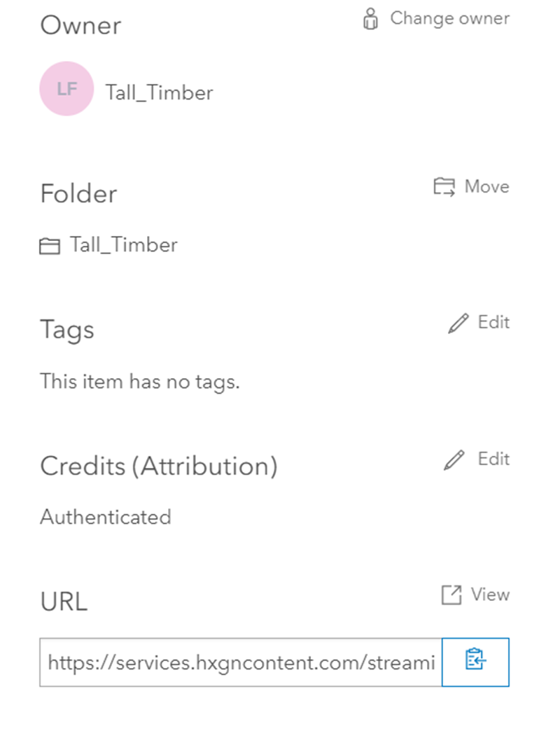

Here are screenshots of the Hexagon layer information:

I’ve been doing some inspecting within your web map and it appears like the print function from WebMapBuilder is not sending thru the access_token during the print; thus it cannot fulfill the request.  I’m getting some headway searching for “arcgis online cannot print secure services”.  So we’ll see what I can find out!
Here is the JSON payload specifics on the Hexagon layer which were sent from the web map to the generic AGOL print services:
            "id": "wms_7506",
            "title": "2020 Hexagon Imagery",
            "opacity": 1,
            "minScale": 0,
            "maxScale": 0,
            "url": https://services.hxgncontent.com/streaming/wms,
            "type": "wms",
            "version": "1.1.1",
            "transparentBackground": true,
            "visibleLayers": [
                "HxGN_Imagery"
There’s no Access Token parameter in there, so the print function can’t access that layer correctly.
We need to find a way to append that access token thru to the print service – it appears like it can be done via ArcGIS Enterprise print utilities, but I haven’t found the documentation for ArcGIS Online – from most of the forums it seems like this was solved at some point in the past
