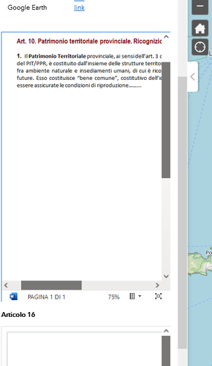

I'm trying to embed a .doc file on PopupPanel widget.
I'm using Microsoft API viewer with code like this:
  <iframe src='https://view.officeapps.live.com/op/embed.aspx?src=https://www.learningaboutelectronics.com/Articles...' width='100%' height='500px' frameborder='0'></iframe>
but it's not correctly working in  Chrome, while it's OK using Firefox.
Any suggestions?
Thanks
Martina

<iframe loading="lazy" src="https://view.officeapps.live.com/op/embed.aspx?src=https://webgis2.ar-tel.it/_test/test.doc" width="100%" height="500px" frameborder="0"></iframe>
this is what I see in firefox.. and it doesn't disappear!!
