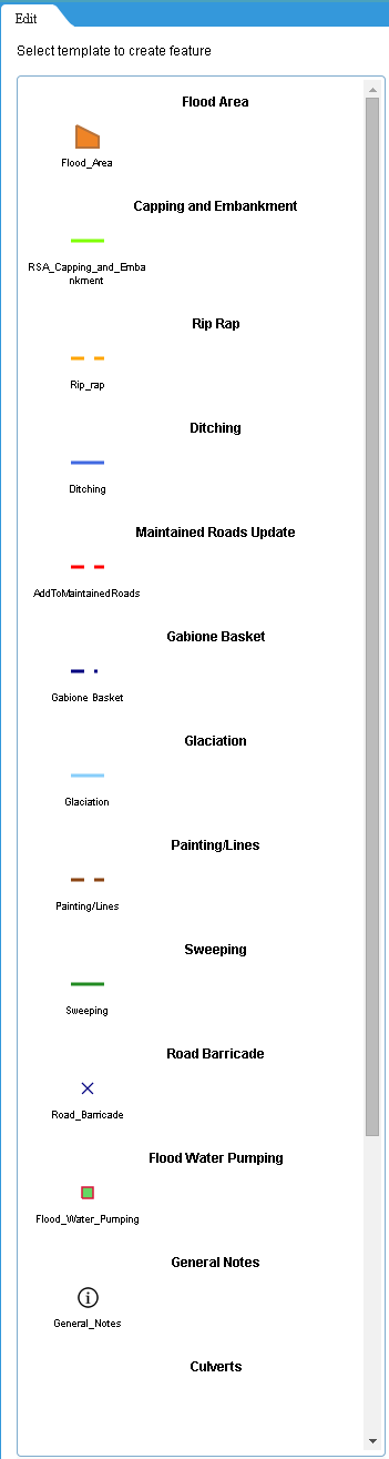

Any else having issues with all of your layers loading in the Edit widget? It only displays the layers that all together make up the width of your screen, so if I were to scroll down in the list of templates (see images below) none would appear past the initial 12 or so layers, which the width of my screen can display without scrolling down. You can see that it doesn't even show the symbology for Culverts. That whole side panel for the Edit widget is buggy.
2014-11-10 16_56_02-ArcGIS Web Application.png2014-11-10 16_56_21-ArcGIS Web Application.png

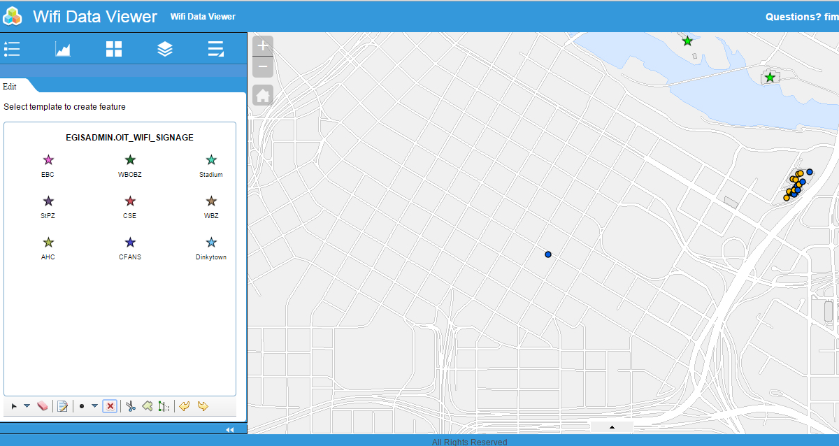

TobiasFimpel1
Interesting, and thanks for posting the workaround @Venus Scott. I did not run into any issue with AGS security running ArcGIS Server 10.1 SP1 with AD as identity store. I agree that the editor widget design is far from perfect. I have had most luck with the theme shown below (I think it's called the "foldable" theme.)

My issue is odd. I've been back and forth with Esri and they are able to load all of my features in any Edit Widget, but they don't know why I can't. As far as I can tell there are two ways in which you can access a Widget within WAB. One is through the buttons that overlay the map itself, such as these buttons:
These buttons open up a pop-up that is small and if I have my Edit Widget setup through one of these buttons ALL of my 19 features are displayed in it. However, the other way to setup a Widget is in one the tabs in either WAB theme, like this:
The pop-up window(panel) with these tabs is set to bigger dimensions by default and the only layers that load for me are those you see in the screenshot in my earlier post. It only displays features that add up to the width of my screen. I've tried dozens of things to fix this. Maybe I can go in and change the size of the feature template symbols displayed in the Edit Widget.

I found out that edit feature templates all load for me in a WAB app that started from AGOL, but not in the developer edition. Esri closed the case because the AGOL version works fine for me, not sure what's going to happen in the Developer edition though and I don't know if anyone else but me is encountering this issue. If I want to setup the Edit widget as a tab in a Developer edition WAB app I just have to go into the apps config.json and change the height of the Edit widget window. Not ideal, but its the only way all the features will display. Maybe I should completely re-install Beta 3 on our server.
