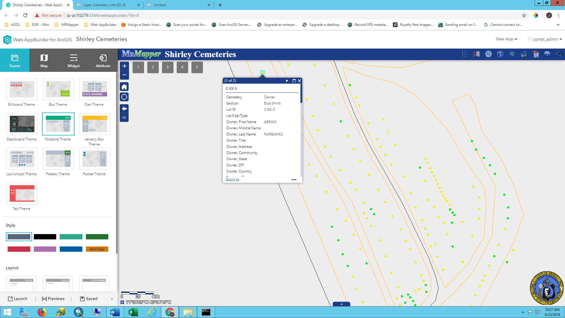

JasonStanton__GISP
It does not dissapear, nor does it display "Searching".  Attached is a screen shot.

  OK. Now I understand. You are getting the empty popup when you click on a query result in the widget. So to disable that you have to comment out this line in the SingleQueryResult.js _onResultsTableClick function:
this.map.infoWindow.show(centerPoint);

One point of note for anyone else that comes across this post - the line of code to comment out is in the SingleQueryResult.js file not Widget.js.
