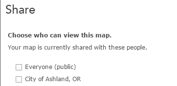

Make sure the web map and services the web application references are shared with 'Everyone' in your ArcGIS Online Organization.

Does the AGOL map that you used have the permissions set to everyone?

Make sure the webmap is shared with everyone on arcgis online

Indeed the problem was that the WebMap wasn't properly shared.  I was confused because the other services are all from my local ArcServer, but the WebMap was the issue.
