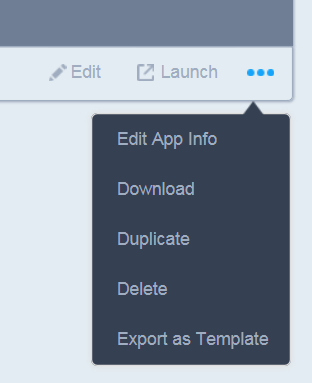

I configured the app in WAB Developer and downloaded it via the drop down to the right of the launch button (screen shot below).  I'll be entirely honest, I'm a bit confused from the start if I should be chasing down that download or the \arcgis-web-appbuilder-1.1\server\apps\[app_number] folder.  In simple terms, will one net me a minified version vs the other netting a non-minified version or is there some other difference?  In either event, I've chased down both and not had any success debugging either in an IDE on a dev workstation (in VS or Aptana anyway).  We were hoping to put the site under source control (VSS or TFS) to manage working on an app collaboratively.  Is this not a "typical" workflow or is this generally handled differently?  Also, I did just try Brackets and it gives me "The webpage at https://127.0.0.1:21561/index.html might be temporarily down or it may have moved permanently to a new web address" when I try to debug the app.  I don't understand SSL but, between what Brackets and Aptana are telling me, is there is an issue with SSL, localhost and whatever web server each ide is using?
