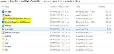

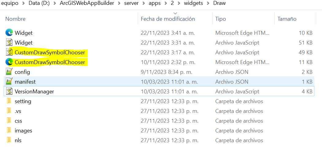

Here is my widget directory/file structure in development:
CustomDrawSymbolChooser.js is a copy from jimu.js\dijit\SymbolChooser.js and customized according to some requirements. I put this file into my custom widget's directory root (as you can see)
CustomDrawSymbolChooser.html is a copy from jimu.js\dijit\templatesSymbolChooser.html and customized same way. Put it also in the widget root directory.

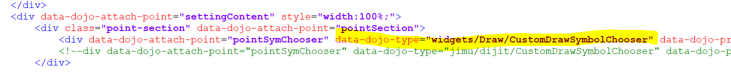

Following is the way how I reference both in Widget.html and Widget.js

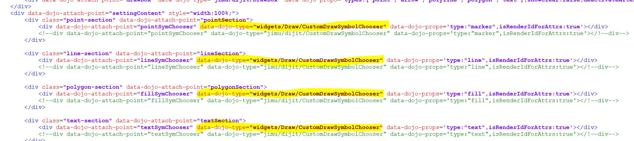

Widget.html:

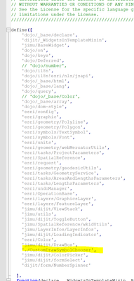

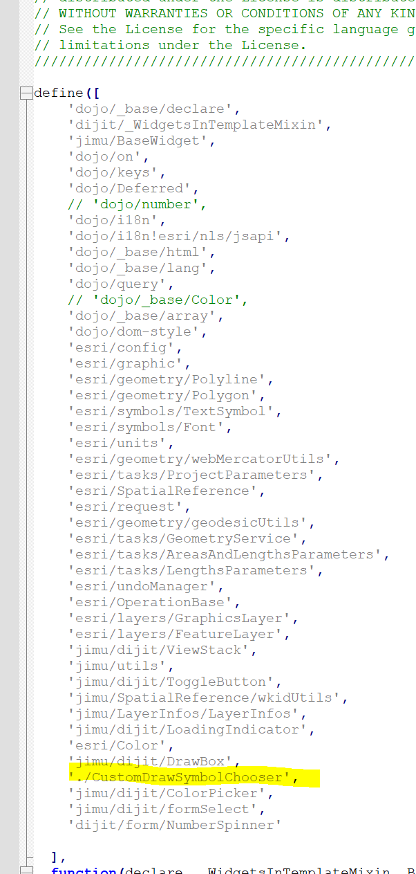

Widget.js:

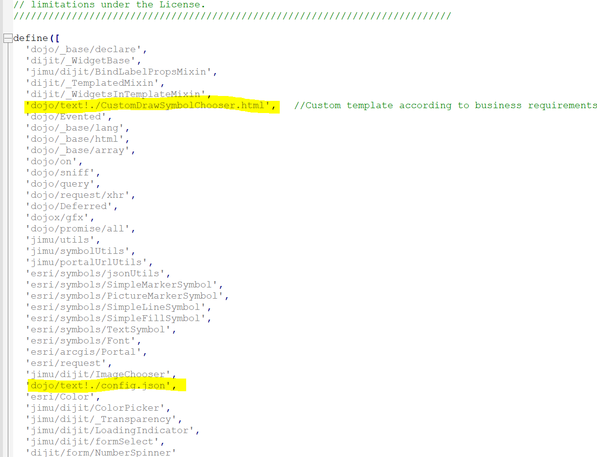

Besides that, I define the CustomDrawSymbolChooser.html template in CustomDrawSymbolChooser.js this way (and also the config.json file i require):
CustomDrawSymbolChooser.js:

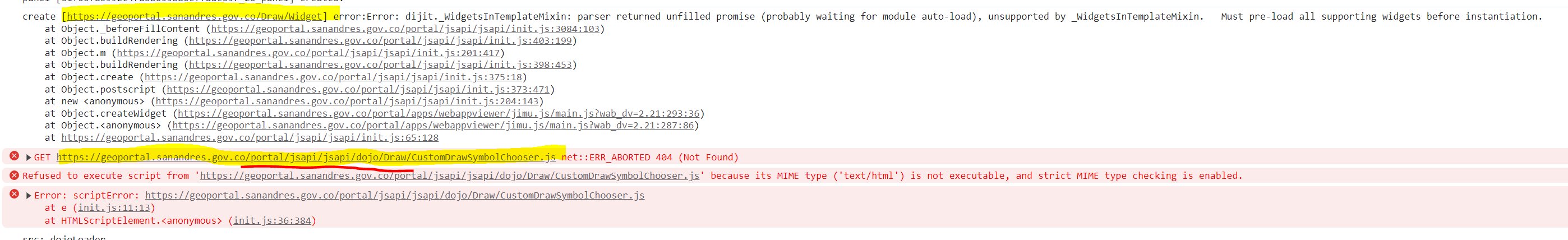

The development and the widget runs perfectly fine in my local environment, no issues or errors. But when I deploy it in arcgis portal and run it in Viewer, there is an error 404
After some error search I found it might be a path reference problem but I have changed every possible invoke path in Widget.html to the CustomDrawSymbolChooser.js file:
data-dojo-type="Draw/CustomDrawSymbolChooser"
data-dojo-type="./Draw/CustomDrawSymbolChooser"
data-dojo-type="./CustomDrawSymbolChooser"
But none of them working. Always "tries" to readdress to ../portal/jsapi/jsapi/dojo/... directory and it doesnt have anything to do with my widget development, I dont know why I tries to call that path.
