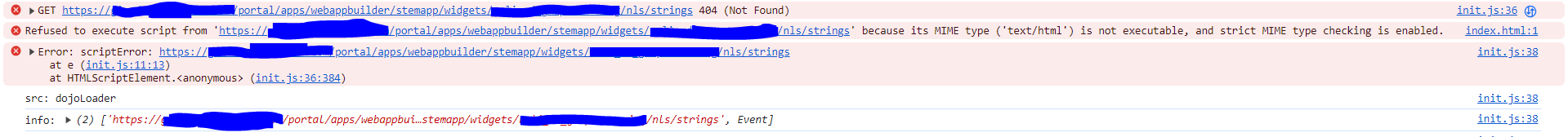

In browser debugger tools console tab, found below error. I confirm that ../nls/strings.js file is available in deployed location. Still it is showing this error. And I observed that, the extension .js is not included in url.
