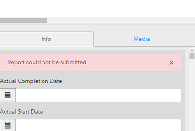

I have a permit management application that is run through the crowdsource manager web appbuilder. They would like the past year's worth of submissions filtered out but leave ones with an approved status. I have placed a definition query on the service to accomplish this filter; however, now in crowdsource manager I am unable to make edits on that status field. I am able to make edits on other fields in the same layer.

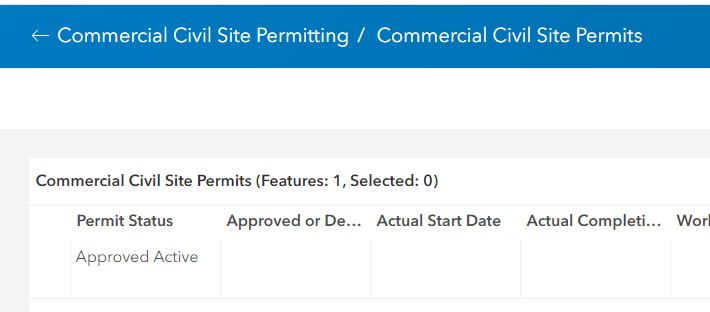

I am able to change the status in the feature layers item description area where the table is viewable.
The goal is that when permits from last year are changed to a status of 'Completed' they will disappear from the viewable dataset in Online.
Is it a known limitation that whatever field you have a definition query on will not be editable in crowdsource manager?

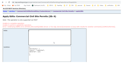

Hi Lauren,
Our dev team looked into the issue and found out applyedit opertation is failing in the service at the rest API and we are seeing the issue in Manager. Here is the error message we are seeing. Unfortunately our team can't do much, please log a bug with the technical support, they will know where to send this issue to.
