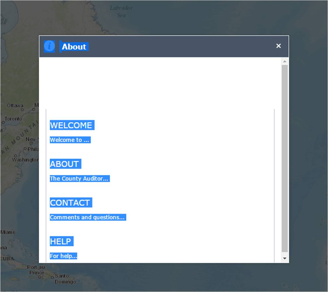

Since completing the Create a New Panel​ tutorial, I have been trying to add a tab container to a modified Demo widget that opens in a modal panel. I can get the content to appear, but it all displays at once and no tabs are visible. Below is an image of what currently  displays. (I highlighted the text with my mouse.) Also below are my code for Widget.html and Widget.js.

Attached is the modal panel.
Any suggestions on how to get the tabs working properly would be greatly appreciated.

William,
Here is the code working (at least n my end it is):
define(['dojo/_base/declare',
    'jimu/BaseWidget',
    'dijit/_WidgetsInTemplateMixin',
    'dojo/_base/html',
    'dojo/query',
    'dojo/_base/array',
    'dojo/_base/sniff',
    'dijit/layout/TabContainer',
    'dijit/layout/ContentPane'
  function(declare, BaseWidget, _WidgetsInTemplateMixin, html, query, array, sniff, TabContainer, ContentPane) {
    return declare([BaseWidget, _WidgetsInTemplateMixin], {
      baseClass: 'jimu-widget-modaltab',
      postCreate: function() {
        this.inherited(arguments);
      startup: function() {
        var tc = new TabContainer({style: "height: 100%; width: 100%;"}, this.customContentNode);

        tc.startup();

WilliamMiller4
Deactivated User
It's working for me too Robert.
Thanks once again!
