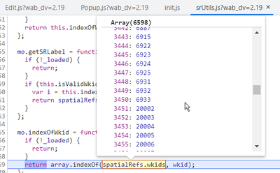

For some reason, it's not loading all of the WKIDs from that page. For example, it's not loading any of them between 6933 and 20002.

I think this is related to the json syntax error in the wkidDetails.json that has been un resolved for several releases now. I guess no one has called tech support about it.
