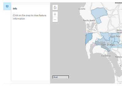

Hi @DuVergerRay , I am also trying to do this, although natively within the AGO app and not hosted on our own. In my case I am using the "Minimalist" web app and want to change the text associated with the docked pop up to be more specific to the data I am showing. But I am stuck with just "Info" and the prompt that follows. I went over the CSS blog/youtube and found, like you, that we can't change the text in these elements with CSS. Did you find a workaround?
