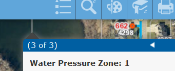

Can somebody point me in the direction of changing the pop-up title color for a particular theme and color?
I hijacked the blue style for the Foldable theme and changed it to a lighter blue for the header background but can't find where to change the title color for the pop-up. I changed the header color in the file location below.
themes\FoldableTheme\styles\blue
Note the difference in colors between the header in the top part of the image and the different pop-up title color below.
Thanks,
Andrew

Andrew,
   Here is the css I use (change the work black for the themes style color name you are wanting to change):
.FoldableTheme.black .jimu-on-screen-widget-panel > .jimu-panel-title,
.FoldableTheme.black .esriPopup .titlePane {
  background-color: rgb(0, 0, 0);
  background-color: rgba(0, 0, 0, 1);

Thank you Robert,
Can you share the file and path where is this information is saved?
Thanks again,
Andrew
RobertScheitlin__GISP
MVP Emeritus
Andrew,
   Sure place it in the [install dir]\server\apps\[app number]\themes\FoldableTheme\styles\[theme color]\style.css
AndrewNiederhauser1
Deactivated User
That did it! Thank you Robert.

LindseyStone
I did the same thing and my widget container widgets and popup stayed the original color.  Using your provided code in this thread it changed both headers, but what about the buttons??
MVP Emeritus
Lindsey,
   You have to add the .search-button to part of that rule:
.FoldableTheme.black .search-btn,
LindseyStone
I didn't know what the exact code was for that search button.  That worked great!  Thanks Robert!
