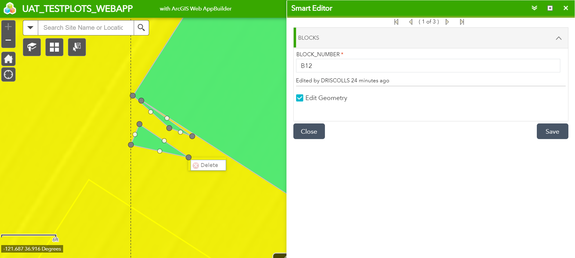

We have some geometries that are multipolygons that were accidentally created during mapping. I am trying to clean them up in AGOL with Smart Editor widget but it seems like I am unable to delete vertices for multipolygon shapes, the option to delete is greyed out:
I am aware that I can clean them up in ArcMap, but I am wondering if it is possible to do this with web app builder so that users that don't have access to ArcMap can still clean up things like this. Does anyone know if this is possible?

Hi @VincentLantaca ,
I am not sure why the Delete button is grayed out for you. Please, would you be able to try doing the same thing with the Edit widget instead? It also provides the capability to delete vertices.
