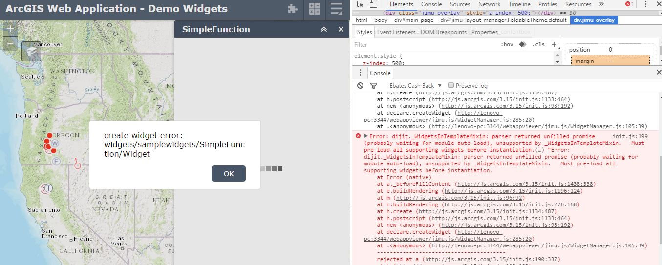

It works well in our web application. But when we copy the widget file to the samplewidgets files( follow the link:Create a custom in-panel widget—Web AppBuilder for ArcGIS (Developer Edition) | ArcGIS for Developer... ), it can not work in the demo widget. The error is as follow:
Error: dijit._WidgetsInTemplateMixin: parser returned unfilled promise (probably waiting for module auto-load), unsupported by _WidgetsInTemplateMixin.   Must pre-load all supporting widgets before instantiation.

RobertScheitlin__GISP
MVP Emeritus
Junxuan,
  Nothing in the samplewidgets folder is included by WAB as there is a specific file .repoignore that tells WAB to ignore any file in the samplewidgets folder.
