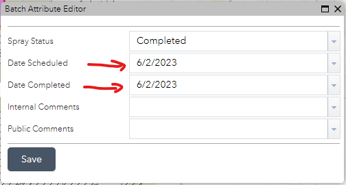

Hi

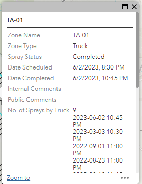

I have a Batch Attribute Editor widget in my WebApp. It works very well until last week. The Date field was used to show both Date and Time, but not now as it currently shows Date only. I confirm that I can see the Time from the pop-up, not in Batch Attribute Editor.
I did try a couple of web maps that has Date field too, the widget still do not show the Time.
What should I do to get the Time back on?
Any ideas/help is really appreciated.
Thanks
This widget do not show Time anymore from Date Completed & Date Scheduled
This pop-up shows Date and Time

@hduong_stpmad5050 , this issue should now be resolved. Please could you confirm that the date/time is now displayed as expected in your application? Thank you!
AlixVezina
@hduong_stpmad5050 Thank you for bringing this up, we are looking into it now.
AlixVezina
