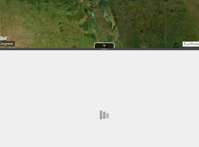

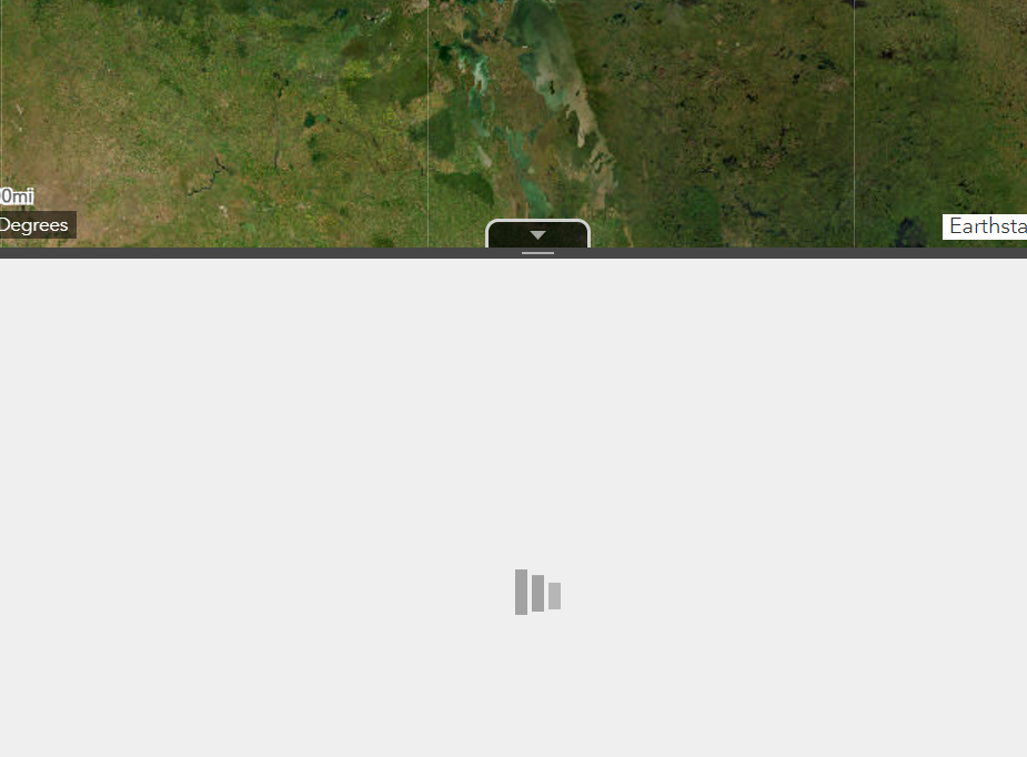

Hey all,
Wondering if anyone else has been experiencing this. Both in my custom WAB applications and ones made from ArcGIS Online, attribute tables are not loading and I am met with a loading screen:
The error that gets sent to the console says:
TypeError: Cannot read properties of undefined (reading 'replace')
at Object.<anonymous> (LayerInfoForDefaultService.js?wab_dv=2.30:426:48)
at init.js:65:207
at r (init.js:110:277)
at q (init.js:110:203)
at a.resolve (init.js:112:280)
at Object.setResponse (RequestBuffer.js?wab_dv=2.30:120:24)
at Object.<anonymous> (LayerInfoForMapService.js?wab_dv=2.30:705:34)
at init.js:65:207
at Object.traversal (LayerInfo.js?wab_dv=2.30:156:10)
at Object.traversal (LayerInfo.js?wab_dv=2.30:161:30) "TypeError: Cannot read properties of undefined (reading 'replace')\n at Object.<anonymous> (https://tract-lt14:3344/webappbuilder/apps/2/jimu.js/LayerInfos/LayerInfoForDefaultService.js?wab_dv=2.30:426:48)\n at https://js.arcgis.com/3.46/init.js:65:207\n at r (https://js.arcgis.com/3.46/init.js:110:277)\n at q (https://js.arcgis.com/3.46/init.js:110:203)\n at a.resolve (https://js.arcgis.com/3.46/init.js:112:280)\n at Object.setResponse (https://tract-lt14:3344/webappbuilder/apps/2/jimu.js/LayerInfos/RequestBuffer.js?wab_dv=2.30:120:24)\n at Object.<anonymous> (https://tract-lt14:3344/webappbuilder/apps/2/jimu.js/LayerInfos/LayerInfoForMapService.js?wab_dv=2.30:705:34)\n at https://js.arcgis.com/3.46/init.js:65:207\n at Object.traversal (https://tract-lt14:3344/webappbuilder/apps/2/jimu.js/LayerInfos/LayerInfo.js?wab_dv=2.30:156:10)\n at Object.traversal (https://tract-lt14:3344/webappbuilder/apps/2/jimu.js/LayerInfos/LayerInfo.js?wab_dv=2.30:161:30)\n ----------------------------------------\n rejected at c (https://js.arcgis.com/3.46/init.js:111:174)\n at r (https://js.arcgis.com/3.46/init.js:110:436)\n at q (https://js.arcgis.com/3.46/init.js:110:203)\n at a.resolve (https://js.arcgis.com/3.46/init.js:112:280)\n at Object.setResponse (https://tract-lt14:3344/webappbuilder/apps/2/jimu.js/LayerInfos/RequestBuffer.js?wab_dv=2.30:120:24)\n at Object.<anonymous> (https://tract-lt14:3344/webappbuilder/apps/2/jimu.js/LayerInfos/LayerInfoForMapService.js?wab_dv=2.30:705:34)\n at https://js.arcgis.com/3.46/init.js:65:207\n at Object.traversal (https://tract-lt14:3344/webappbuilder/apps/2/jimu.js/LayerInfos/LayerInfo.js?wab_dv=2.30:156:10)\n at Object.traversal (https://tract-lt14:3344/webappbuilder/apps/2/jimu.js/LayerInfos/LayerInfo.js?wab_dv=2.30:161:30)\n at Object.<anonymous> (https://tract-lt14:3344/webappbuilder/apps/2/jimu.js/LayerInfos/LayerInfoForMapService.js?wab_dv=2.30:694:16)\n ----------------------------------------\nError\n at then.e.then (https://js.arcgis.com/3.46/init.js:113:97)\n at Object.getLayerType (https://tract-lt14:3344/webappbuilder/apps/2/jimu.js/LayerInfos/LayerInfoForDefaultService.js?wab_dv=2.30:424:38)\n at Object.getSupportTableInfo (https://tract-lt14:3344/webappbuilder/apps/2/jimu.js/LayerInfos/LayerInfoForDefaultService.js?wab_dv=2.30:453:12)\n at https://tract-lt14:3344/webappbuilder/apps/2/widgets/AttributeTable/utils.js?wab_dv=2.30:365:29\n at Object.forEach (https://js.arcgis.com/3.46/init.js:73:69)\n at Object.<anonymous> (https://tract-lt14:3344/webappbuilder/apps/2/widgets/AttributeTable/utils.js?wab_dv=2.30:364:13)\n at https://js.arcgis.com/3.46/init.js:65:207\n at r (https://js.arcgis.com/3.46/init.js:110:277)\n at then.e.then (https://js.arcgis.com/3.46/init.js:113:152)\n at exports.readConfigLayerInfosFromMap (https://tract-lt14:3344/webappbuilder/apps/2/widgets/AttributeTable/utils.js?wab_dv=2.30:362:6)"
