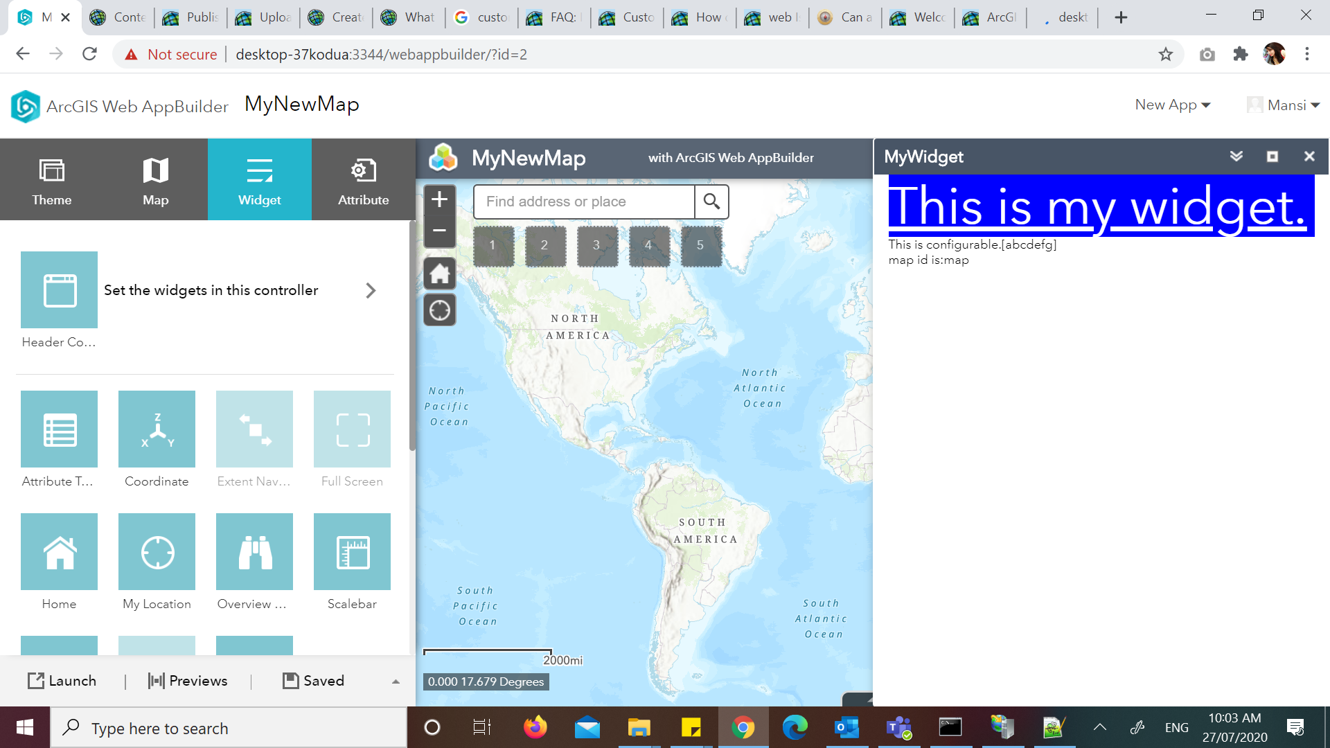

I have created custom widget in web app builder for ARCGIS named MyWidget. i am able to use it into web app builder.
You can see that in screenshot.

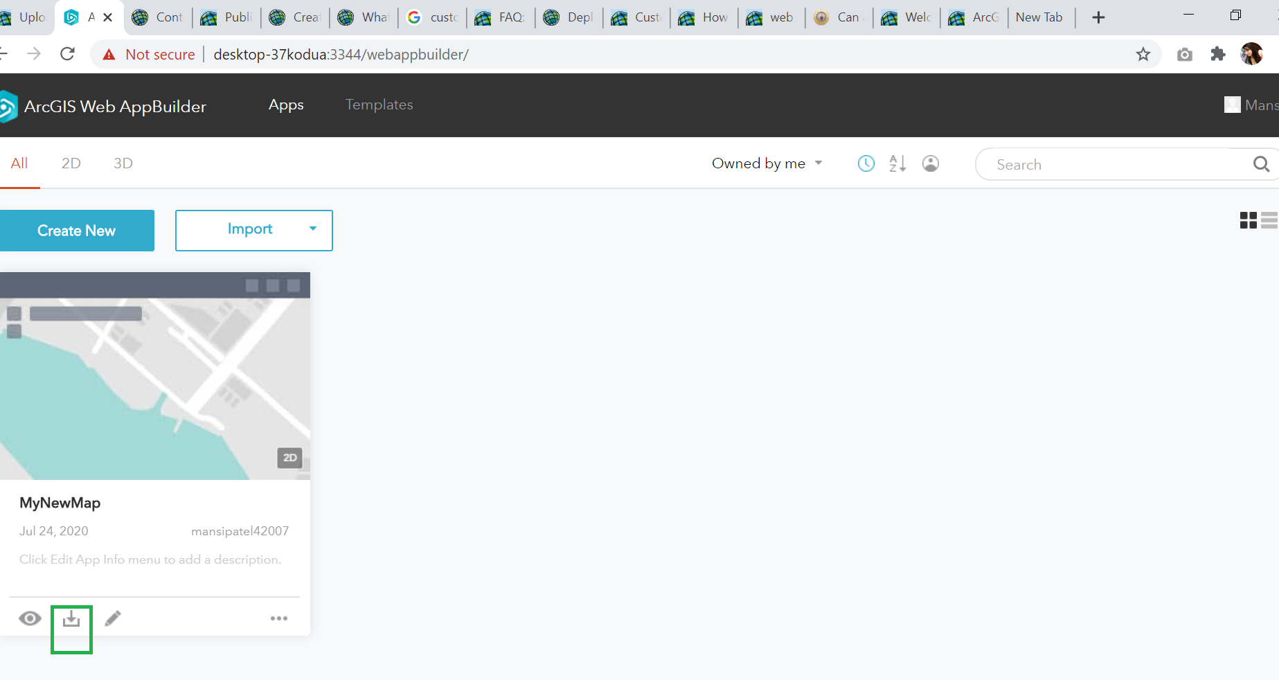

2) I have downloaded code from web app builder as .zip file & When i am publishing my application on my local server means IIS it showing me following error. it shows blue screen with white loading bar in middle of the screen but then page fails to load. please check attached screen shot. Even, I have tried with steps given by Robert but still its not working for me. Please provide solution of my problem.

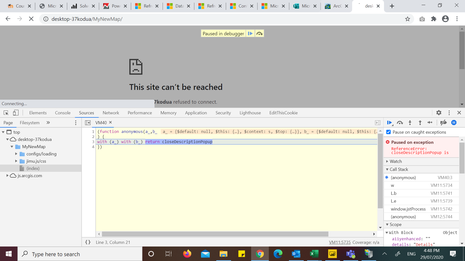

For Deployment on IIS:

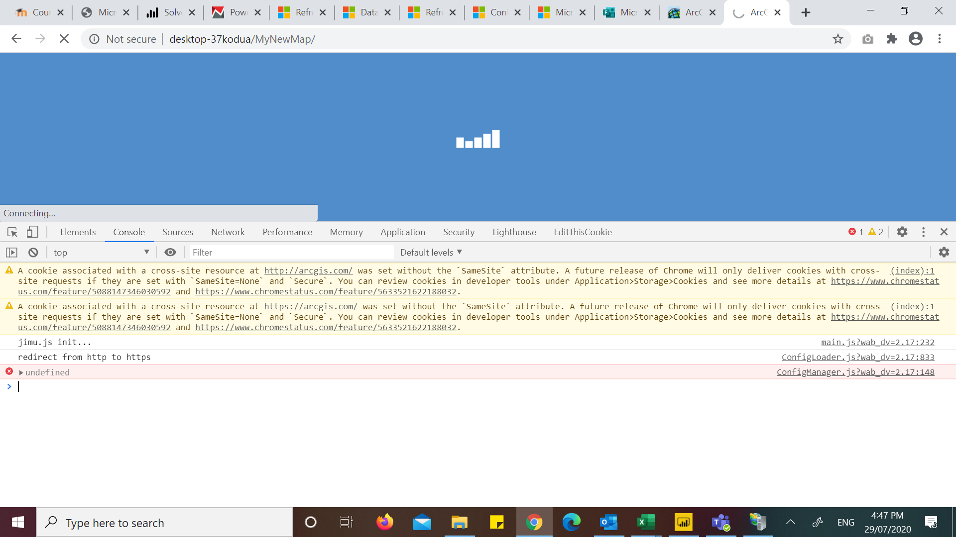

I have checked console errors but its showing nothing to me just showing undefined i clicked on but page will go into fail screen. please check the screenshot below. Is this issue happen because of https in URL?? do i need to do settings for that?
Please provide me you valuable feedback. Its really helpful for me.

Are you using a https or http url for your portal url in WAB? Seems like you are mixing content (http and https) which can be an issue.
In the screenshot you have an undefined error. You need to expand that error and see what is undefined in the ConfigManager.js file.

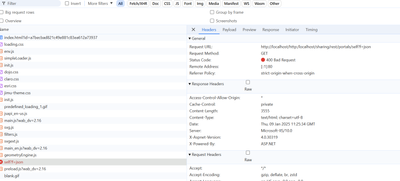

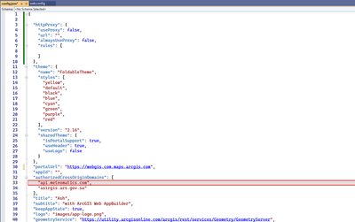

ashraf88

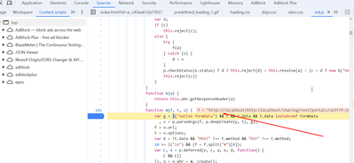

dear  Robert Scheitlin, GISP i have this error
and this my config
can you help what is error
