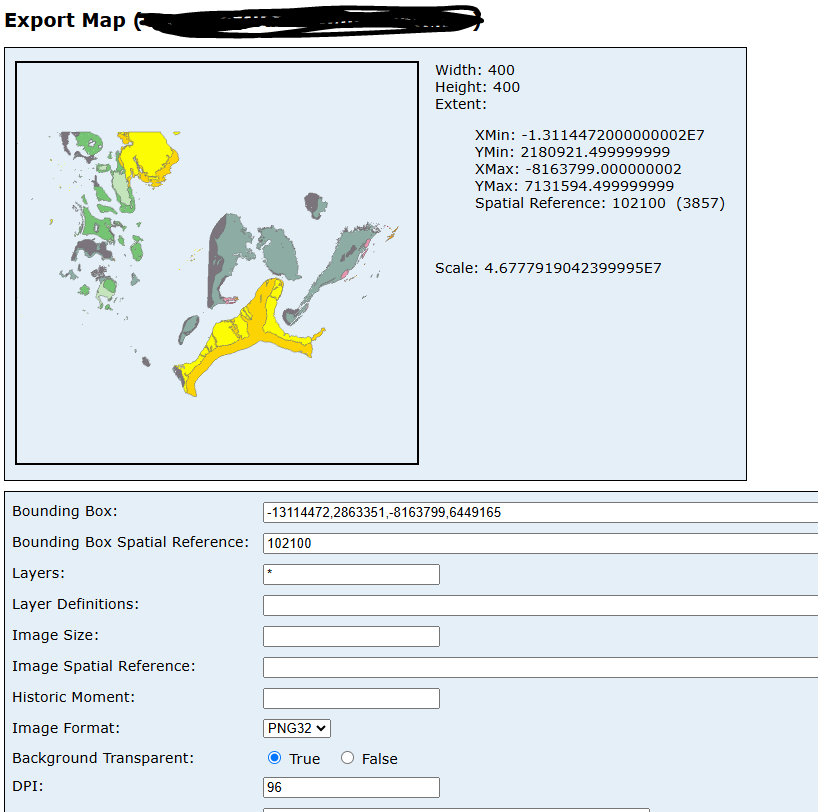

One layer coming from an ArcGIS Server 10.9.1 is not drawing in the app. It will not show the legend in the Layer List widget. Clicking "Description" at the layer level returns a 500 error, but clicking it at the service level does take me to the REST endpoint. I can query the REST service with the same parameters in the request from the app and data returns successfully, so it seems like a problem with the app. I've overwritten the service with no luck.

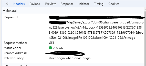

Looking at your web debugger and comparing the url to your manual rest query, they are different. The URL shows layer=show:-1, different bounding box, and different output size. I think the show:-1 means to hide all layers. So you would have to figure out why that is set to hide all layers. To check if that is the case though you can take the url from web debugger and put it into a browser window and tweak that parameter to see if you can get it working.

Thanks for the response, and thanks for catching those differences! The "layers=show:-1" seems to be the issue here. I copied that request and pasted in a browser, changed the -1 to 0 and it returned an image of the layer just fine. The problem now is, I have no idea why that parameter gets set on the requests for that layer in the app. It doesn't seem to be set for any other layers. I've looked at the configs for the Layer List widget and the app itself and don't see any way to specify that specifically. It's also strange that I still get a 500 error when trying to go to the REST page for the layer of that service.
