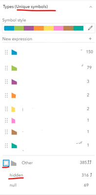

Option 4: Unique Symbols, using an Arcade expression
if($feature.ConfirmationField != "Yes") {
    return "hidden"
return $feature.RoadType
Then symbolize by unique symbols, drag and drop the "hidden" legend item into the "Other" category, and uncheck that:
Have a great day!

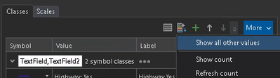

Uncheck "Show all other values":

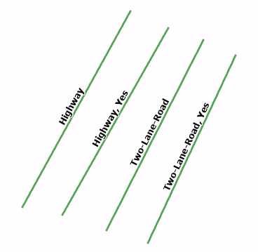

This will hide all features with null values in the confirmation field. BUT, while option 1 doesn't include those features in the layer, option 2 does, it only does not draw them. You can still see them in the attribute table, and they are still getting labeled:

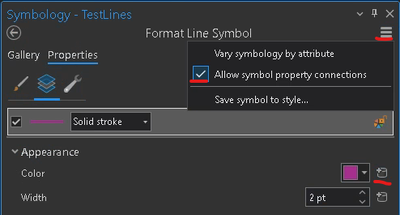

Change to "Single Symbol", format the symbol. Allow symbol property connections and click on the button next to the color picker:
Click on the expression button, copy/paste and edit the expression below, apply everything.
    return "hidden"
Have a great day!
Johannes
MariusVerdes
Hi Johannes,
Thank you so much, this work perfectly.
gissavvi3
@JohannesLindner
For option 3, I don't have a button next to the color picker. What version of pro are you using? I currently have 2.9
JohannesLindner
MVP Alum
This was probably 2.8 or 2.9
Make sure you allow symbol property connections (top right of the image under option 3.
Have a great day!
