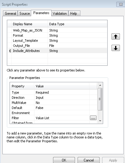

I am having trouble adding a custom parameter ( not a customtextelement) to the WAB print widget.
I have added
To my arcpy script, and published it.  However when i load the script as the path in the WAB 2.4 print widget, i get

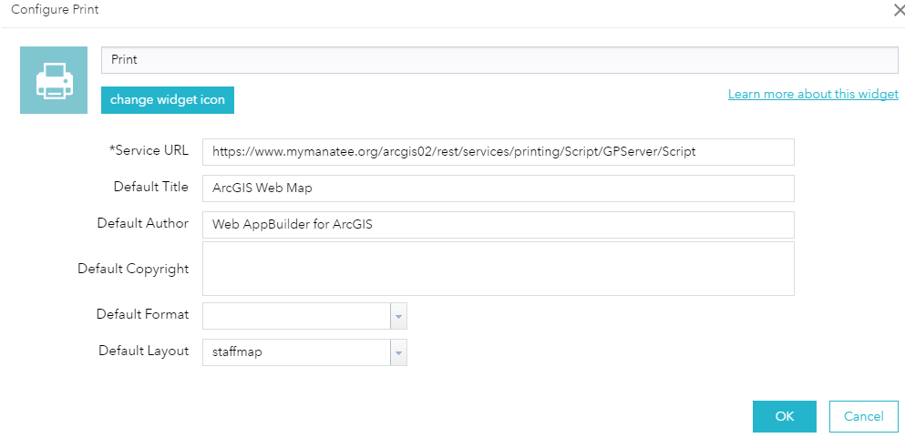

And the user cannot set the new parameter value.
The ?json response of the script does include the parameter, so i can't figure out why it doesnt display.  It also does not display in the WAB print widget config dialog

Any Help would be appreciated.

Jeff,
   Just because you add a new parameter to the print service does not mean that the print widget know anything about that parameter or has any code to use that parameter. You would have to add code and html elements to the print widget to interact and use that new parameter.

oh, rats.  i assumed it would just loop through the list, and present each parameter as a choice based on its settings.  Bad assumption i guess.

   Yep, not that lucky.
