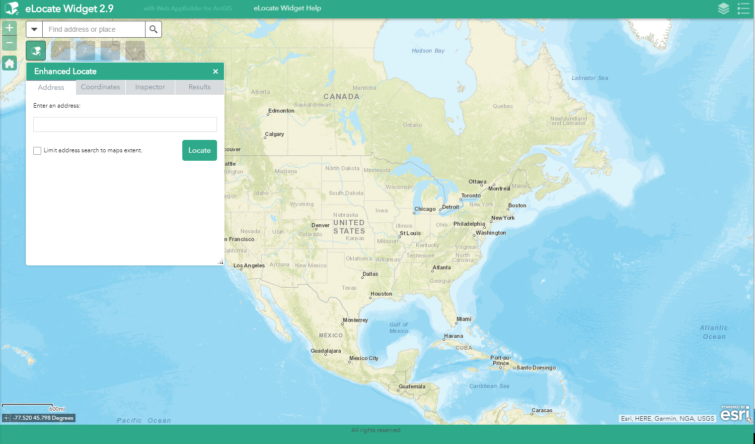

Here is a screenshot of me having it working in the foldable theme using the instruction I have provided.

   No nothing that simple. The Footer widget does not exist in the Foldable theme so you have to copy the footer widget from the tab themes widgets folder into the foldable themes widget folder. Then add it to your foldable theme apps main config.json making sure the uri point to the right path ("themes/FoldableTheme/widgets/Footer/Widget") and then you have to adjust the bottom position of the map element in the config.json to account for the footer widget. i.e. (line 8):
  "map": {
    "3D": false,
    "2D": true,
    "position": {
      "left": 0,
      "top": 40,
      "right": 0,
      "bottom": 25
    "itemId": "18df7255535b41f8ac37e7855222a9ef",
    "mapOptions": {},
    "id": "map",
    "portalUrl": "http://calhoun.maps.arcgis.com"

RobertScheitlin__GISP
MVP Emeritus
Sounds like you did not adjust your maps bottom position property like I mention in this reply
https://community.esri.com/thread/220295-add-footer-widget-to-foldable-theme#comment-794989
MVP Emeritus
