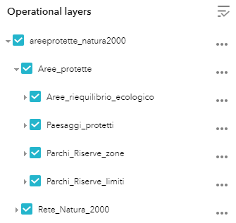

I would like some help with the Add Data Widget. I have to add to my map all the layers included in this WMS service:
http://servizigis.regione.emilia-romagna.it/wms/areeprotette_natura2000

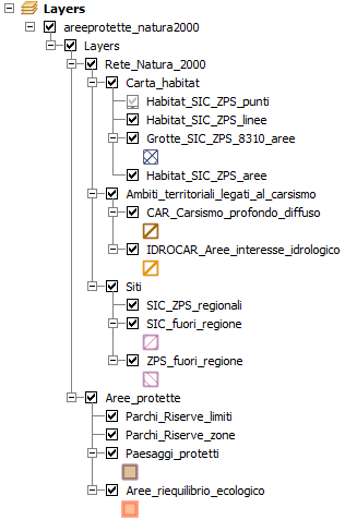

If I add it in ArcGIS Desktop, I get two group layers, one ("Aree_protette") containing four layers and another one ("Rete_Natura_2000") containing three group layers.
When I add it using the Add Data Widget, the group layer "Aree_protette" is loaded perfectly, while "Rete_Natura_2000" appears as closed, but it's empty.
I tried with other WMS services, and they get added perfectly, so I think that the problem resides in the WMS service. Maybe the three-levels group layer is a bit too much to handle?
