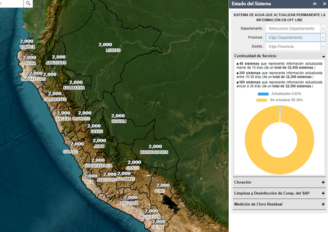

Activate tags in WebAppBuilder.

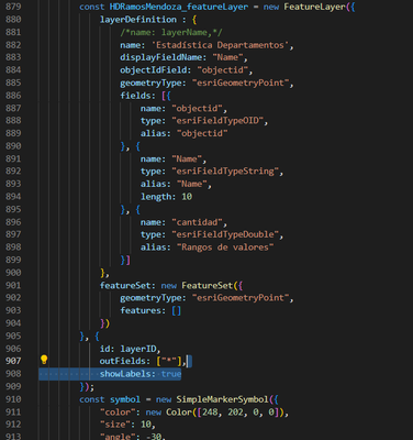

I've created a layer with new FeatureLayer. Also turn on the "showLabels: true" labels. It is not shown on the map.

I am creating a layer by code. According to the documentation, it tells me that I must create the property "showLabels: true" in the object new Map().
I am looking inside the WebAppBuilder code for the new Map() object to add the property "showLabels: true"

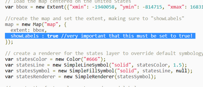

They ask me to add the in the MAP object showLabels : true
https://developers.arcgis.com/javascript/3/jssamples/layers_label.html

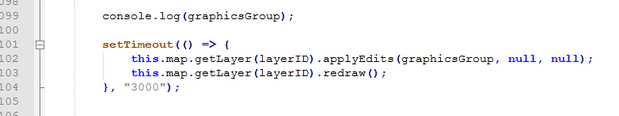

Al crear asignar el valor a la geometría de puntos, se toma su tiempo de milisegundos pero se soluciona con un settimeout
