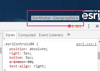

Good morning everybody,
I am trying to add some text to the ESRI attribution in the bottom right (see attachment).
How would I access this element? When I inspect it, it doesn't have an id, it only has a class.
Thanks!
Tim
Tags (1)
RobertScheitlin__GISP
MVP Emeritus
Tim,
  Sure this is pretty straight forward:
Require: 'dojo/dom-construct'
var myDiv = domConstruct.toDom("<div style='right:5px;bottom:22px;position:absolute;text-align:right;z-index: 9;'>hello world</div>");
domConstruct.place(myDiv, "map");

   The map has a attribution property that returns the Attribution dijit
TimWitt2
MVP Alum
Thanks Robert I didn't even think about that.
How would I add some custom text above "Earthstar Geographics"?
MVP Emeritus
The Attribution dijit is designed to display the attribution text in a single line and truncate it at a certain string limit until the user clicks the dijit, for it show more text. You would have to do css manipulation to attempt to override the single line nature of the dijit. You would probably be better off adding your own dom element above it.
TimWitt2
MVP Alum
Do you have an example on how to add a dom element above it? I really like this idea.

KierenTinning2
Robert, for a Web AppBuilder Developer Edition app, which file would we need to modify to add our own custom attribution logo?
I can over-ride the Powered By Esri with this code in index.html
#map .logo-med {
background-image: url('images/XYZ.png');
height: 40px;
width: 180px;
But what I'd really like to do is add our own image along side of it.  I like the idea of inserting the DOM element, but would you have advice on which page this would need to be inserted on?
