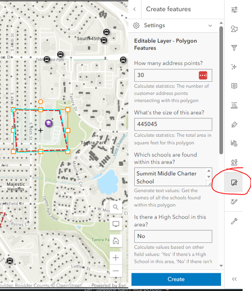

Depending on your version of ArcGIS your options will defer. But if you're using ArcGIS Online or Enterprise 11.0 or later, Calculated expressions in the new smart forms may be an option for you as you can define the presets to show up depending on the edit context (on feature create or update). This is the functionality that will replace the Smart Editor widget when Web AppBuilder retires.
Here are blogs with some examples:
One limitation to keep in mind though: a field with a calculated expression (preset value) assigned becomes read-only. That preset value is hardcoded into the field and the user will not be able to modify it while editing that feature.
You can play with some examples in this web map using the Editor widget:
