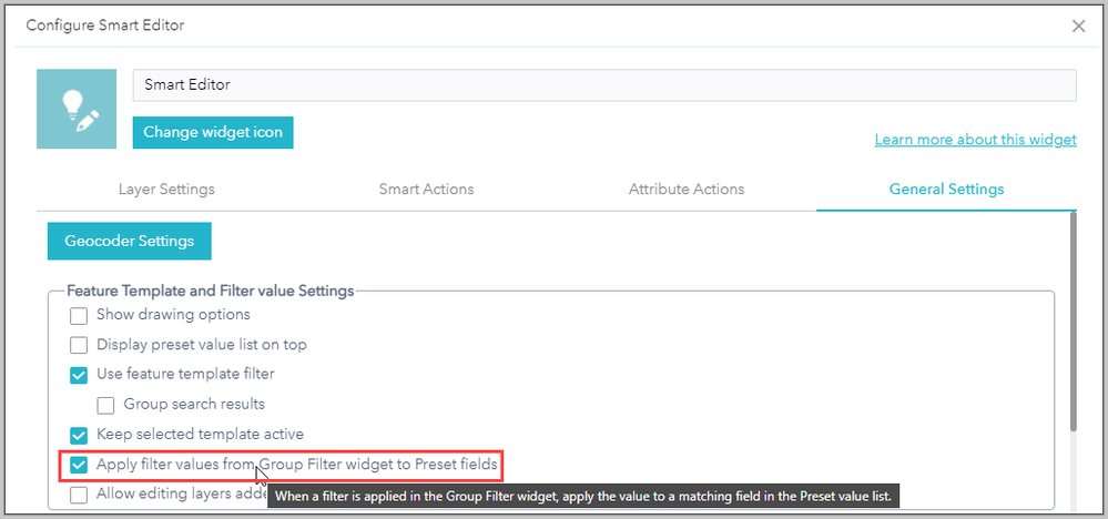

In Web AppBuilder, you can set up an interaction between the Group Filter widget and the Smart Editor widget to use the filtered value as a default value for attribute fields when you create new features.

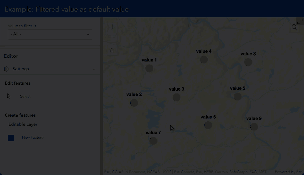

As illustrated in the example app below, when a user filters features from the Event map to view a specific event, the event name value will be automatically populated into the Event identifier field for any new features they create for that event.
This option can be enabled in the Smart Editor widget General Settings, along with setting up Preset Attribute Actions and proper filters in the Group Filter widget.

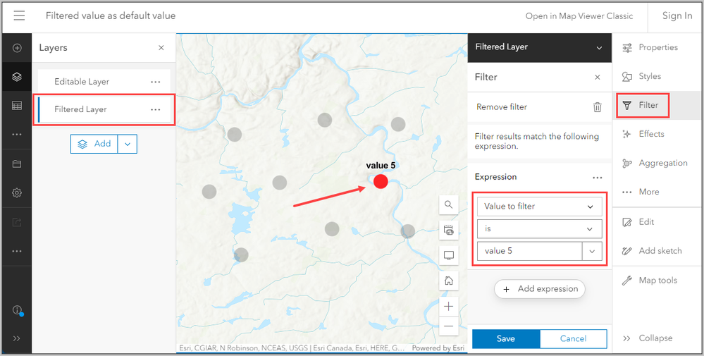

1. In Map Viewer, apply a new Filter Expression on the Filtered Layer for one of the values (e.g., value 5 below).
2. Then, use the Edit tool to add a new feature for the Editable Layer.
Notice how the value from the remaining feature (value 5, in the example above) is written into the field automatically.

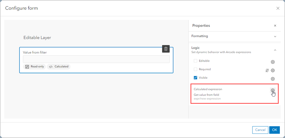

How was this achieved? Let’s take a look at the Form:
3. Open the Forms configuration for the Editable Layer.

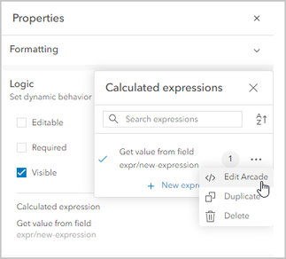

4. For the Value from filter field you'll see a Calculated expression is set.
5. Click the gear and Edit Arcade to view and modify the expression. 
