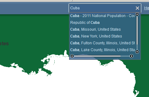

Is it possible to restrict the Header Controller Search function to just my Map Service? I have it set up to look in my map service (2011 National Population data) and do not want it to also add in results from a Geolocator service, Currently it is even through the headercontroller xml does not have it listed.Code I have is listed below.

  Sure you just add usemapserviceonly to your geocoder tag:
<geocoder>
    <usemapservicesonly>true</usemapservicesonly>

RayCrew
Perfect fix.
