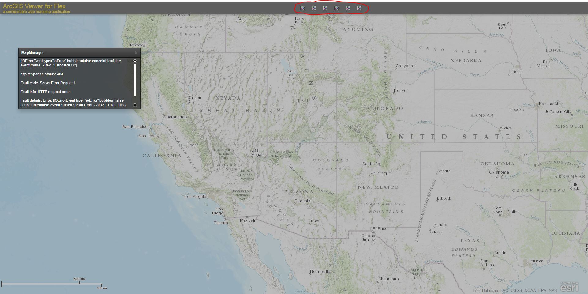

I was wondering if anyone know how to fix the issue of error 2032. In my case, I have the following error when I run flex viewer from flash builder. I have wasted hours on trying to figure out this issue and yet still no luck.
When I run flex viewer from flash builder I am getting 9 error windows but after I closed each and everyone of them, the application would become more and more visible after every one of those error boxes were closed. I've included the error as well as a screenshot below.
[IOErrorEvent type="ioError" bubbles=false cancelable=false eventPhase=2 text="Error #2032"]
http response status: 404
Fault code: Server.Error.Request
Fault info: HTTP request error
Fault details: Error: [IOErrorEvent type="ioError" bubbles=false cancelable=false eventPhase=2 text="Error #2032"]. URL: http://localhost/mytestwebsite/arcgis-viewer-flex-3.6-src/widgets/MapSwitcher/MapSwitcherWidget.xml

Chuck,
   It sounds like you have an issue in your URL path for the widget config files. If you try and paste this url in your address bar in your browser do you get the XML in the browser? http://localhost/mytestwebsite/arcgis-viewer-flex-3.6-src/widgets/MapSwitcher/MapSwitcherWidget.xml

Hey Robert,
I am getting an error page when I run that URL in the browser. What do you suggest that I do to remdy this?
