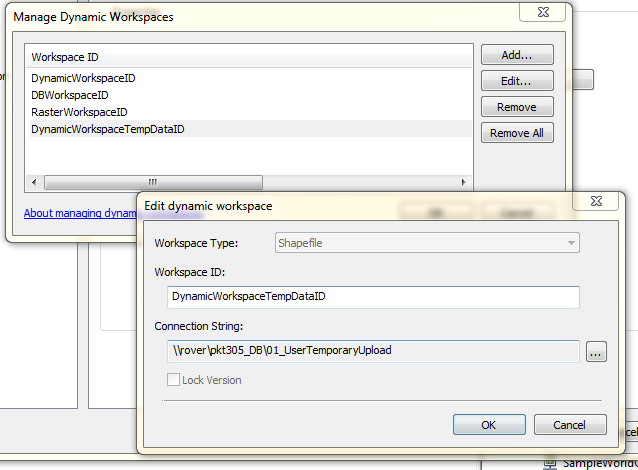

I'm trying to add a dynamic layer, to my map, based on a shapefile.
I created a workspace as in the image

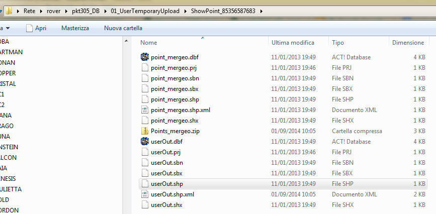

Shapefiles are store in subfolders inside folder specified for the workspace: i.e.
But if I try to request the datalayer, it seems arcgis server (10.1) doesn't find the shapefile:
Thanks in advance.

RobertScheitlin__GISP
MVP Emeritus
Teresa,
   Does your ArcGIS Server account have read access to the \\rover\pkt305_DB\01_UserTemporaryUpload directory?
teresafazio
Deactivated User
Yes.

teresafazio
Deactivated User
The problem seems to be the subdirectory; if the shapefile is in the root directory (\\rover\pkt305_DB\01_UserTemporaryUpload) everything works fine, when I move it in a subfolder of the root folder, arcgis server generates error.

teresafazio
Deactivated User
Not for me, or rather the behavior is strange: if the shapefile is saved directly into the subfolder of the root folder, arcgis server returns the error message (Unable to find the specified 'datasourceName' in 'dataSource' for dynamic DataLayer with 'id' : -1.) ; but if I save the shapefile first in the root folder, and then move it into subfolder, everything works, or perhaps simply because the rest response is in the cache. Therefore I would ask you to try the first way. Thank you for availability.
Teresa
MVP Emeritus
Teresa,
  I see the same issue now with sub folders. Not sure what to tell you besides call Tech Support.
