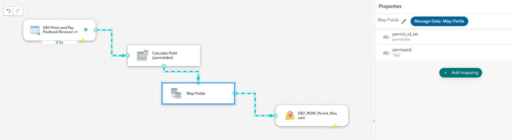

Hello All!  I am looking for ideas and suggestions to build a Velocity Analytic that updates an attribute column on an existing record in a ArcGIS Online Hosted Feature Layer.
I set up a http receiver feed that ingests delimited data with a record ID that matches ID in my hosted feature layer and want to update a column to 'Yes' anytime a matching record received from this feed; please see Analytic screenshot below.  This Analytic is not doing anything currently; the record remains unchanged.

The setting Keep only latest feature for each Track ID value is functionally the same as Update a Feature in GeoEvent Server.
You don't need to make it a Velocity hosted feature layer with a pre-defined Track ID field for this to work.
If you already know which field/column is the primary key used to update existing records, you can use the Map Fields tool. In the tool, tag that field with TRACK_ID.

Were you ever able to get this implemented on your end?  I did some testing here, and am unable to get the field mapping to work out.  The static layer I bring in to get all the fields that are not being updated doesn't appear to transfer through after the Join Fields.

Do you have a Track_id on the Feature Layer, and be sure that the output from the "Map Fields" specifies the same Track_id, or use "Select Fields" to limit the number of fields you are passing to the "Feature Layer".

I believe the Track ID is the issue... the existing output feature layer was created outside of Velocity, so has no Track ID defined.
A little backstory on our process: the existing feature layer we want to update a single column on via Velocity is a permit info layer that is created and maintained by Survey123 and other web apps, integrated with Power Automate and has 300+ fields.  It would be impractical to rebuild this as a Velocity-managed layer.
Going to keep investigating... but think this may be impossible unless the layer was created/is managed by Velocity.
