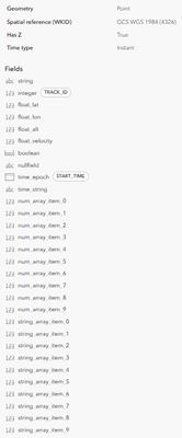

For example, I have a Feature Layer output that has Track ID and Start Time values defined with Point Geometry. This feature layer has the following schema:

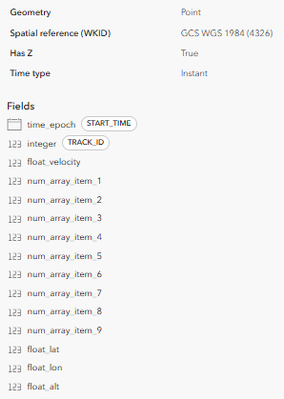

I want to update a few (but not all) of the fields in my feature layer's schema. I've created a new HTTP Poller input that has the same Track ID and Start Time fields as well as the same point geometry. This source also includes a subset of my feature layer's fields.
If I connect this new HTTP Poller feed or data source to a Feature Layer (existing) output set to "Keep only latest feature for each Track ID value" in a real-time or big data analytic, I note that there are no validation errors even though the pipeline's schema does not exactly match the feature layer's schema. When the analytic is run, existing features (identified by Track ID) are updated to use the new attribute values from the HTTP Poller input. Any fields that were not explicitly included in the HTTP Poller's schema will retain their original values.

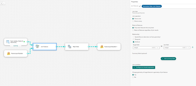

On the Target port of the Join Features tool, I've connected my new HTTP Poller feed which has a partial schema update (no geometry). On the Join port, I've connected the feature layer that I want to update so that I can get the geometry for each Track ID and join it to the data from the HTTP Poller feed (note that I've set the "Change geometry of target feature to geometry of join feature" parameter to True. If we were missing other key fields, we could add them in this join as well). After the join, I use a Map Fields tool to remove the COUNT field created by the Join Features tool before the Feature Layer (existing) output so that the schemas match. Now that the pipeline includes the correct geometry, I can run this analytic as expected to update my feature layer. We are considering future enhancements to expand this workflow to allow attribute edits without also providing the geometry.
