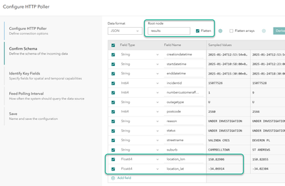

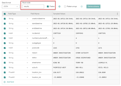

@SimonGIS are you specifying a Root node when deriving the schema?  Ex:

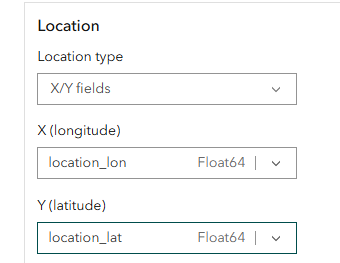

You should then be able to create geometry from the location_lon and location_lat fields:

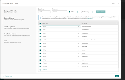

You will need to specify on the Configure HTTP Poller > Confirm Schema page:
  • a root node of results
    • This tells Velocity to only process data and records from within the "results" array
  • check the box of Flatten
    • This reduces the "{"lon": 150.82906,"lat": -34.06914}" string down to location_lon and location_lat field
Additional documentation on flattening and root nodes available here

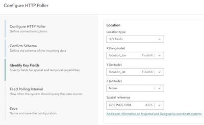

Then, click next and proceed to Identify Key Fields and specify the geometry fields:
The above is the expected way to configure geometry from this source provided.

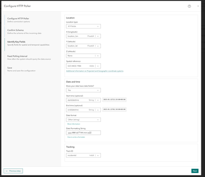

I can confirm I initially followed the exact same steps as above, but in this workflow I get duplicate records being recorded and the Track_ID seems to fail.  Starting from scratch:
Note below I am using the incidentID as the Track_ID

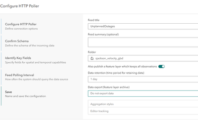

Schedule every minute and output to a feature service for testing:
At time of writing, there are 9 unique records in the feed.  The feed has initialised 4 times, and I have 4 duplicate sets of records:
If I repeat and ignore the date field entirely - same result.
