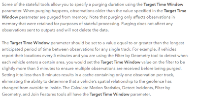

According to the ESRI documentation,  (https://doc.arcgis.com/en/iot/analyze/perform-real-time-analysis.htm), the "Target Time Window" does effect how many features are stored in memory and used in the comparison process, but I couldn't find any information about when the features are purged if they get set back to their original state (in the case of Detect Incidents, if this would mean the first feature following a purge would have a status of "Started").

7 Days seems a little on the other extreme.  But if you are not comfortable with what you see versus what you are expecting, maybe open a support case.   I know there were issues around the timer and the state set, but I thought those were resolved in one of the four dot releases.
