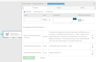

Track Functions can be use in the Calculate Field and Map Field tool arcade expressions:
Here is a sample workflow using a simple AVL feed tracking snow plows with a driver name attribute that could change as time passes.
Using DriverName and the TrackFieldWindow to send a notification when the change is detected.
TrackFieldWindow ( fieldName , startIndex , endIndex )
fieldName = driverName accessed as 'driverName'
startIndex = Past Feature (-1) accessed using TrackFieldWindow(-1,0)[0]
endIndex = Current Feature (0) accessed using $feature.driverName

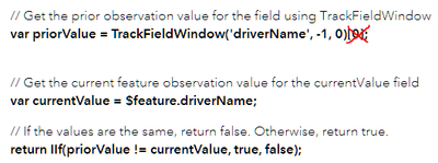

// Get the prior observation value for the field using TrackFieldWindow
var priorValueArray = TrackFieldWindow('driverName', -1, 0)[0];
// Get the current feature observation value for the currentValue field
var currentValue = $feature.driverName;
// Handle the case where the first value does not have a prior feature
// If there is a prior value, determine if the value changed
if(count(priorValueArray) < 1){
return false;
} else {
return IIf(priorValueArray[0] != currentValue, true, false);
Then if the past feature and current feature are the same it returns - False
If past feature and current feature are different is returns - True   indicating a attribute change.

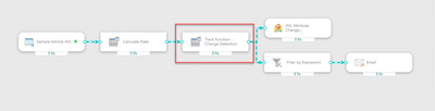

Once you have that set you can leverage the filter tool to detect that change the send out a notification.
This is just one example but this workflow can be modified to reflect other use cases

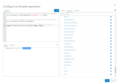

ArmstKP
@JeffEismanGIS
I copied the expression that you wrote and added my field name in.  I get this error, though.  Any idea?
ArmstKP
@JeffEismanGIS Can you tell me why I might be getting the above error of "Out of Bounds"?
JeffEismanGIS
I have seen that error before.  Is your feed running?   If not start in and try it again.  If it is running can you send me a sample of your data to look at. I think you have the option to message me directly.
JeffEismanGIS
@ArmstKP In looking a bit more into your problem there is one frontend limitation in array access of prior features, but we have a simple workaround that I could assist with on a call and screenshare. This will be fixed in our late Feb release.

@brudo @JeffEismanGIS Brudo, that is an interesting observation, I will have to look into it.  I did make a change to the expression that Jeff posted above.  I removed the '[0]' and the expression tested successfully...
