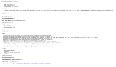

  2. Can you provide a screenshot of the "fields" section of this layer on the service layer REST endpoint?
ArmstKP
@PeterNasuti I have shared two layers with you.  Two different versions of the same feature layer.  Here is the screenshot:

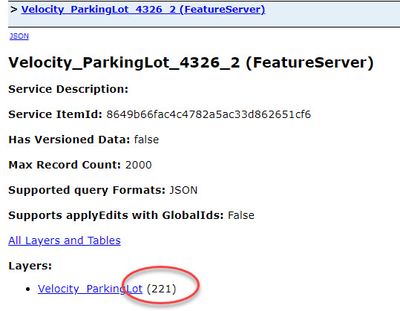

PeterNasuti
@ArmstKP Thanks for sharing this layer with me! I was able to reproduce the issue and can confirm it is due to the fact that your only present layer index for this service is 221, rather than the expected 0. I wrote an enhancement/bug on our side to enhance the product to lookup layer IDs dynamically for the Feature Layer (existing) output rather than assuming the first layer index is 0.
