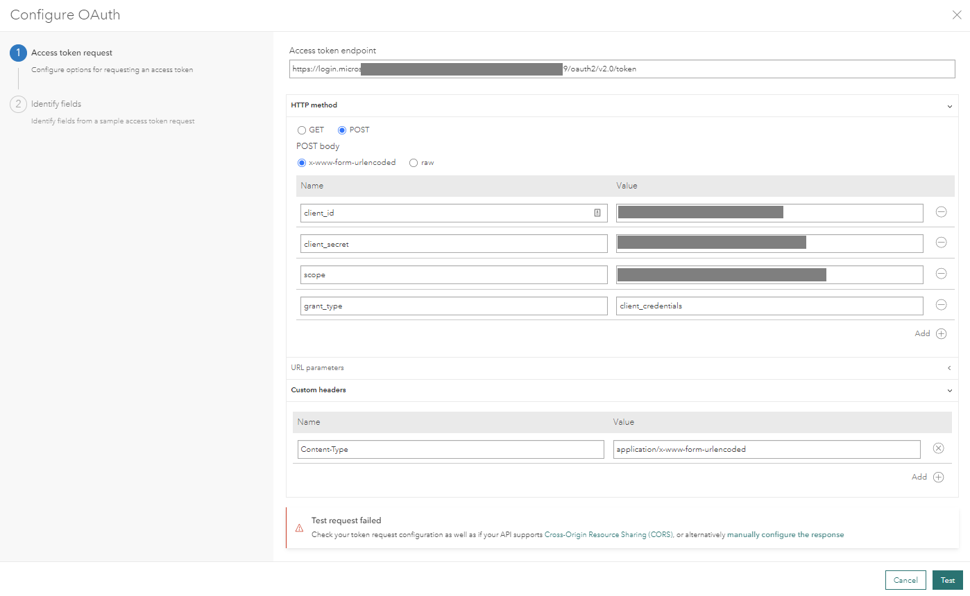

Hello,
I wonder if anyone has experience with OAuth authentication in ArcGIS Velocity. Or if there are any examples available.
I am trying to connect to API secured with OAuth 2.0. I choose "configure OAuth" inside HTTP Poller and define token endpoint. I provide all authentication details under POST body, but I constantly get the response that "test request failed".
I test the same connection inside Postman and there, I can get an access_token in response. Request body parameters and token URL are exactly the same.
That's why I wonder if there are any exceptions inside ArcGIS Velocity or some additional configuration one should be aware of. I would appreciate any tips.

SindreEngh1
We figured out that the issue was the response from the oAuth service, it's missing a parameter that Velocity expects, the 'Access-Control-Allow-Origin' in the header
We got the following error in the console when trying to configure the call:
Access to fetch at 'https://id.serviceprovider.no/connect/token' from origin 'https://velocity.arcgis.com' has been blocked by CORS policy: Response to preflight request doesn't pass access control check: No 'Access-Control-Allow-Origin' header is present on the requested resource. If an opaque response serves your needs, set the request's mode to 'no-cors' to fetch the resource with CORS disabled.
Since the developer of the API did not response to our wishes to add the header parameter to the response we ended up with creating a proxy services that adds this to the header.
Workflow: Velocity calls our Proxy, the proxy calls the oAuth service, the proxy gets the response, adds the Access-Control-Allow-Origin header and then send it to Velocity. Probably not the best solution, but it works for now 😉
