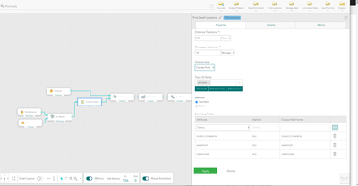

I am trying to accomplish your last bullet point.  I want to know when a snow plow is within or very near a parking lot polygon, then create a convex hull from the VehicleTracks using the Find Dwell Feature Tool, then if that intersects with the parking lot polygon, I will then take the timestamp of when it was processed and calculate the lastserviced field with that date.  I have tested this and my model never outputs any records, even though if I look at my tracks it should trigger an output:
PeterNasuti
@ArmstKP Thanks for the additional info!
Looking at the metrics of your analytic, "Find Dwell Features" has 0 records, so we can identify this tool as the "blocker" to explain why your model has no outputs. This tool more than likely has no outputs because of your properties "distance tolerance: 500 feet" and "time span tolerance: 15 minutes". When a plow truck is moving around plowing a parking lot, it is still in motion and getting bread crumb updates at distance and time span greater than the tolerances specified. Therefore, none of your AVL track points satisfy a "dwell" per this criteria, so this tool has no output. You could adjust the distance/time tolerance to better identify parking lot plowing speed as a dwell, but this could capture many other events when the plow truck is merely driving slow or plowing elsewhere. Rather than diving into analytic design for that tool configuration, lets consider a few things.
