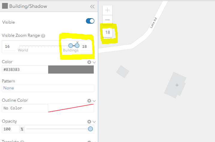

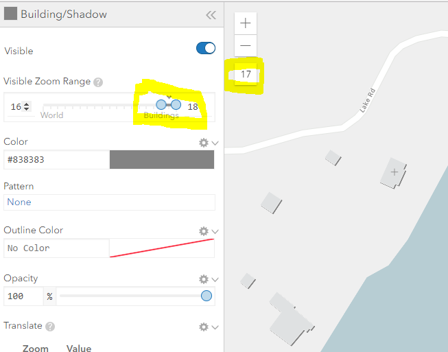

Love the new editor.  One thing that may not be working right:
-playing with light gray basemap, editing building shadows
-it is set for scale levels 16-18, but when zoomed into level 18, it turns off
pics below:
level 17, all looks good, you can see that dark shadow accenting the buildings
level 18, shadow turns off but shouldn't
Actually this is true at any level, meaning if I set the upper limit of the visible range to level 17, when the map is drawn at level 17 the layer does not show.
In this way (that it does not include the level that is set as the upper scale range), there is no way to have it draw at the largest scale (level 18).
Perhaps I am missing something.
Tom S.

TomSchwartzman
Thanks Allan - I found a workaround, and that is to manually type "19" into the zoom range upper limit box.  Obviously should not have to do that, but at least it works.

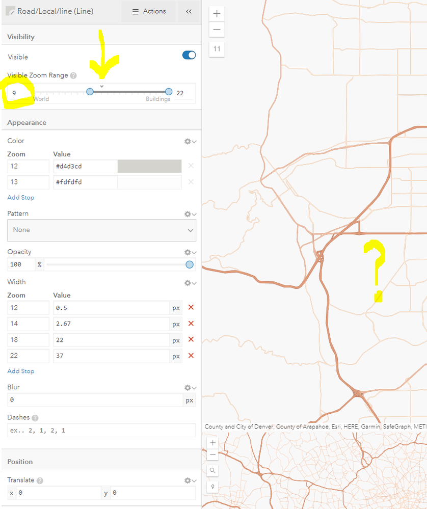

I have encountered this same problem as well when working with the World Street Map vector tile layer. I can change the Visible Zoom Range for road lines but the roads still disappear when I zoom out and the visible zoom range is still valid.
For example at a zoom level of 12 the Road/Local/Line features are visible. However even with the visible range set from 9 to 22, the roads disappear when I zoom out to various zoom levels within the valid range.
Zoom Level 12, Roads are visible
Zoom Level 11 roads disappear 😞
I'm not sure what I'm doing wrong here. I've tried saving and reopening. While the zoom range is saved, the roads do not honor it. I've tried with various other road layers and the zoom levels seem be working properly.

Forgot to mention that I tried the solution above with no luck.
