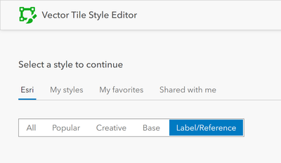

AlderMaps
I'm a little late to the party here (was searching for an answer to the main question), but thought I would give this a shot. If you want basemap labels to draw on top of other features, you can select a "Label/Reference" layer to start, modify it if you want, save it as an item to your portal, then load it in your map (not as the basemap), and ensure it's above your other layers in Contents.
Not sure if it will automatically load in the basemap or not; if it does; you should be able to select additional options for the basemap and for that layer, then select "Move from Basemap". Drag it to the top of contents and it will draw above your other layers. Obviously in this case you want to ensure the remaining basemap does not have labels; modify in Tile Style Editor as needed.

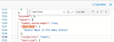

TWPFSecretariat
Thanks Mark and Matt for this exchange. Made it a lot easier than me going through the reference documents trying to find the right syntax to remove labels. I used "text-font" to find and replace with "visibility": none and it looks great!

John-Foster
To follow up on this issue we recently added an embedded JSON editor so that you could do this type of edit without downloading, editing with an external editor, and then uploading the JSON. To edit in the VTSE directly, once your style is loaded, select Edit JSON from the tool palette.
Edit the JSON, use ctrl-F to find, and make your edits. When done, click the Update button to validate the JSON and apply the edits and update the map.

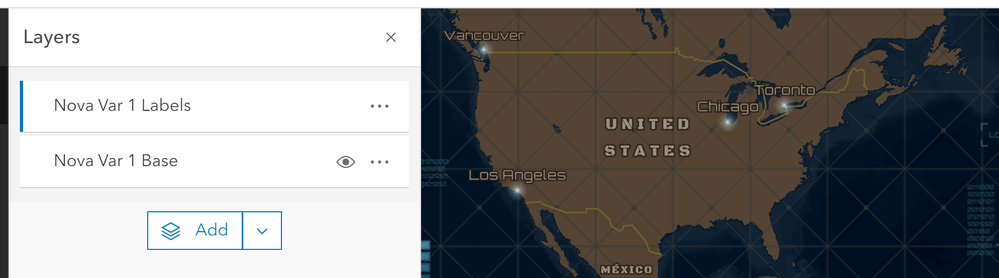

AlderMaps
I came up with another method to accomplish kinda-sorta what this post is about (turn off all labels / have labels drawn on top of other features). I wanted to use the Nova basemap but wanted the labels to draw on top of everything else (so two separate layers in the map, the labels on top and the base on the bottom).
I grabbed the JSON for one of of the labels-only styles in the Vector Tile Style Editor, grabbed the entire JSON for the Nova basemap, and threw them in a text comparison app (e.g. https://text-compare.com). I could then see exactly where in the JSON labels stop and everything else starts. Having identified the split point, I just snagged one half (labels) of the JSON and saved it as one item in my content, then snagged the other half (base) and saved it as a separate item.
I found ripping out the label JSON and saving it separately (if needed) was faster/easier than turning the visibility off for ALL labels in the JSON.
Publicly shared items in my work account (I also did a little high-level color modification):
https://alder.maps.arcgis.com/home/item.html?id=94f8de9cb54a47a69e2c987414b81294
https://alder.maps.arcgis.com/home/item.html?id=f8db135fc80642c0a88f67ce68011fc1
Now I can sandwich whatever layers I want between the basemap data and the labels:Screenshot 2023-06-30 101712.png
