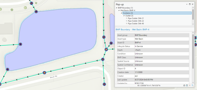

The boundary of a basin should also be modeled using the BMP Boundary asset group in the Structure Boundary layer. Each Basin will then contain all the BMP Inlets, BMP Points, and outlets associated with the basin. The various device features contained within the basin allow you to model the connectivity/flow for how water can enter/exit the basin.
See screenshot from sample data below:
