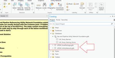

Great answers by John and Robert. Here is some additional information regarding Gas UN/UPDM documentation:
Because a significant number of gas users are familiar with the Geometric Network and ArcMap, the task framework in Pro may often be overlooked because of a lack of familiarity. This is where a lot of the documentation for the UN, data model, and workflows are located. It should be helpful to spend some time reading through the different steps as you explore the solution and test and configure the capabilities.
Here is an additional link which discusses the asset package in greater detail:
Introduction to the asset package
