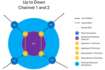

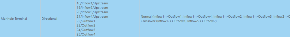

We tested Point #3 with our Crossover valid path (instead of Normal [All]), which is similar to what was suggested to us:
Esri’s documented scenario (from the thread / product guidance) assumes a directional manhole with multiple upstream and downstream terminals (e.g. two upstream + two downstream). However, in our case, we only have 3 ports, where the flows separate downstream.

After switching valid paths to Crossover (confirmed applied successfully on the terminal configuration):

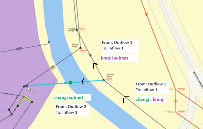

  1. Upstream trace from the manhole/controller area only consistently recognises one subnetwork side (Kranji in our test case, seen in the screenshot at the start).
  2. Upstream trace for the other subnetwork (Changi) stops prematurely — it does not continue to the upstream sewer segment that is topologically part of both subnetworks through the manhole.
  3. We attempted an alternative terminal assignment on the Changi subnet downstream sewer (Outflow 1 → Inflow 1). That change causes subnetwork validation failures because the subnetworks are no longer self-contained.

 I suspect there are multiple things happening. Let's start with something simple. Connect the lines on that manhole as shown below, configure an upstream trace with the "use digitized direction" option, and run the trace. Then post a screenshot of the resulting trace (it should look correct).
