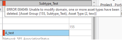

Hi folks,
I’m facing a confusing behavior while working with a local Utility Network (File Geodatabase) in ArcGIS Pro, and I wanted to check if anyone has seen the same.
Scenario
  1. I created:
    • A new Asset Group (Subtype) = Subtype_Test
    • Two new Asset Types (coded value domains – Short Integer)
  2. Then:
    • Assigned the Asset Type to the Asset Group → Save > Success
  3. But:
    • When I try to switch to the second Asset Type, I get:
ERROR 004049: Unable to modify domain, one or more asset types have been deleted
AssetGroup(155,SubtypeTest),AssetType(2,tew)
Notes
  • Both Asset Types are newly created
  • They are not assigned to any other Asset Group
  • No additional configuration steps were done (no rules, no topology changes, etc.)
  • The issue happens immediately after initial assignment
  • A colleague tested the same workflow:
    • Different machine
    • Different ArcGIS Pro version
    • Different Domain Network (Water) and mine is Electric.
      Same issue reproduced
Also, I’ve reviewed the following source, but it doesn’t provide clear guidance or a practical solution to the issue.
ArcGIS Pro 3.6 & ArcGIS Pro 3.2
RobertKrisher
You need to determine which code you deleted from the domain and re-add the original code and description to the domain before you can reassign it.
5 Replies
RobertKrisher
In ArcGIS Pro 3.6 and earlier, once you have assigned a domain to an asset group, you cannot remove any of the codes or descriptions associated with it. If you unassign the domain then assign a different domain to the asset group that has different codes/descriptions, you will get this error.
DasheEbra
Hello Robert, thanks for reply
Unfortunately, this doesn’t appear to be related to the Pro version. I’ve tested the same scenario on version 3.4 and encountered the exact same error.
Also, if you review the link I mentioned in my post, you’ll see that Esri lists this error for multiple versions—from 3.4 through 3.6 and I believe it likely affects earlier versions as well.
RobertKrisher
We are saying the same thing, so I'll try my response in a different way. You cannot remove any asset groups or asset types from the utility network. This means that if you unassign a domain then assign a different domain and any of the codes or descriptions are different, it will fail and you will get this message.
We do plan on allowing you to change descriptions of asset types/groups in later releases, but there is still not a timeline on adding support for removing codes.
ElaventhanMurthy
Hello @RobertKrisher, thanks for the reply. I'd like to know the best way to fix this error now. Should the user simply reassign the original domain to resolve the issue, or is the problem more complex than that?
RobertKrisher
