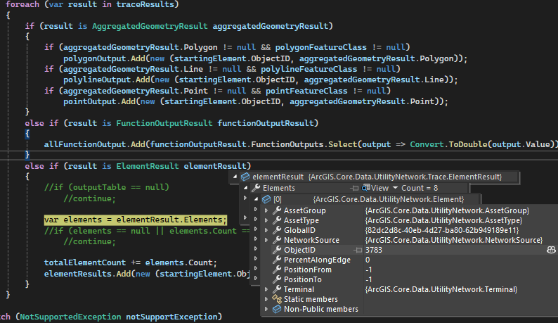

The .NET Batch Tracing Core Host method appears to be no faster than the Python / GP execution. I'm pointing to my production Enterprise feature service for UN and starting points (mid-points of water mains), rather than the Naperville (FGDB). You can see in my screenshot below it's returning elements just fine. No different than how it would look in Python, except Python is a little easier to watch/debug and I've already invested time into the custom actions around the tracing.
Using the same trace configuration (pointing to water pressure tier) it takes ~7 seconds (sometimes barely a second) per trace. Unless you suspect something isn't configured correctly in my .NET solution, I have to assume Python is still just as good as anything. Running the trace directly from REST endpoint is the same time as well.
As for manually inspecting results, I don't think I'm able to parse the results to handle it all in one trace. My condition barriers are defined by a single field in our valves feature class ("Is_PP_Divider" = Yes), not relying on a closed vs open status, and our filter barriers are Category IS_EQUAL_TO SPECIFIC_VALUE Isolating. So there is no way to further dissect the results when this is all I have available. No properties that help me pick out the barrier (isolating) vs contents (isolated).
  • elements (networkSourceId, globalId, objectId, terminalId, assetGroupCode, assetTypeCode)
  • sourceMapping
  • resultTypes
I think I'll abandon the .NET method and return to my Python solution...which still seems to require multiple traces.
