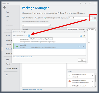

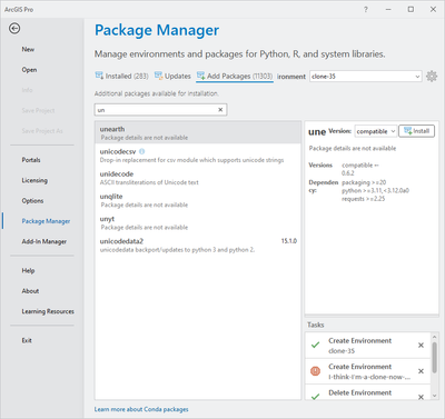

I just created a new clone using ArcGIS Pro 3.5.0. At first, the tools aren't visible:
Then I refreshed the metadata for my packages.
And then they appeared.

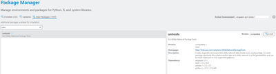

I can find it here on my own Pro:
I would check to be sure you're in the Add Packages section, or check the Installed/Updates for potential updates!

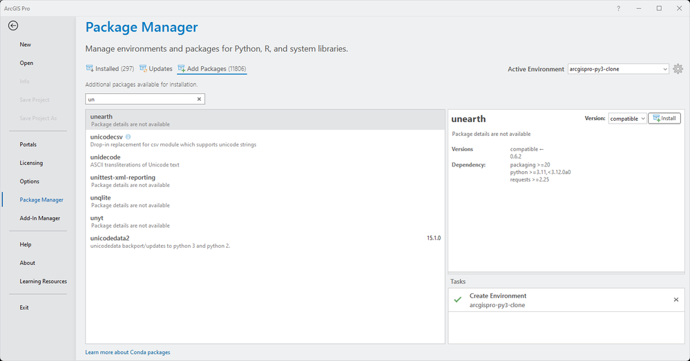

SanchezNuñez
Hi @RobertKrisher
See attached screenshot using cloned Conda.

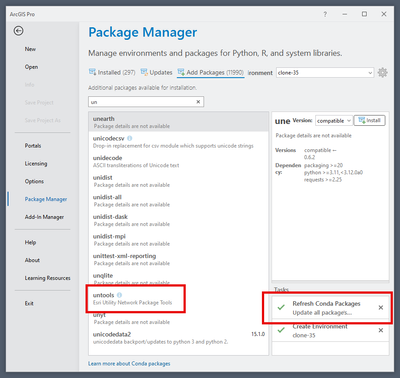

SanchezNuñez
Found it!!
I just refreshed the exiting tolls and now the “untools” shows on the “Add Packages” list
