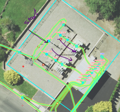

Hi Team,
Hoping someone has come across this and may be able to help.
I have a substation with 33kV and 11kV lines. When I run an upstream trace I notice that it has not selected the elements encircled in green.
When I trace downstream it works as expected.
What am I missing?

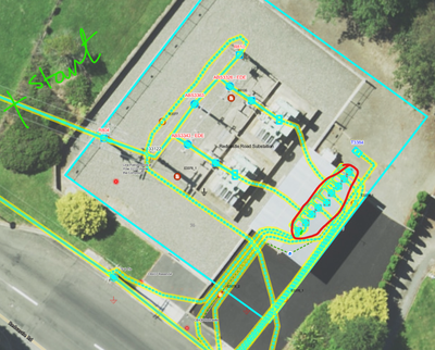

@MikeMillerGIS  - It's the same as before.
Expected result is that the green path drawn below should be highlighted as well.
When I do a connected trace it selects both paths (which I think is to be expected)
Same result when I do a downstream trace it correctly selects both the sections.

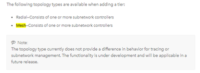

Based on what I am seeing there doesn't appear to be a problem with subnetworks or the connectivity. Could it be the topology - mesh or radial that could be the issue?
But my understanding is that attribute should have no effect on the trace.
