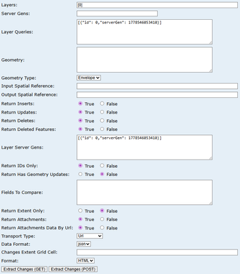

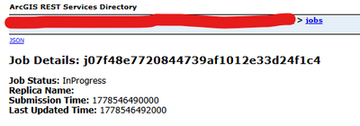

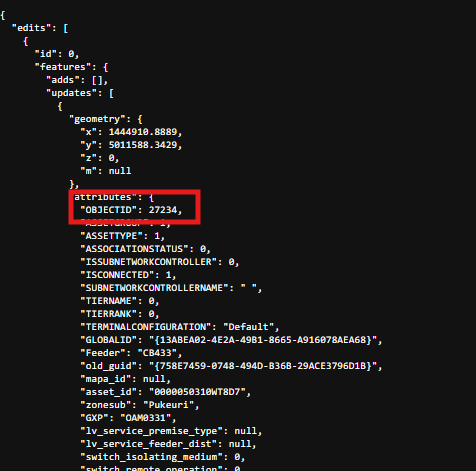

@geovolve - Do you get the servergens parameter via the webhook URL?
I think what has tripped me up in the past is the "Server Gens" vs "Layer Server Gens"
Also I was under the impression that ServerGens is a timestamp because it looks like one.

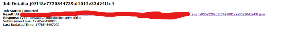

Just did a quick test -
Results - I moved an ICP (objectID = 27234)
If you select returnIDs only = False, the job should run asynchronously meaning it will return a status URL for the job. Once completed you can access the results URL with all the changes.
As people have pointed out, it does take a sometime so you need to build this into logic
Do Until...JobStatus = Completed.
Once JobStatus = Completed, then download the JSON to get the details.

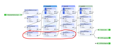

We don't have the UN implemented in our organization but I have done some testing with Feature Service webhooks in our Enterprise 11.3 environment in conjunction with FME Flow. I have found Enterprise and AGOL feature service webhooks to be more cumbersome to work with than virtually any other platform.
What I've found is that it appears that FME is making the HTTP calls to Enterprise before Enterprise has the data packaged and ready to respond (which is why a response is never received). I used a hacky way to get FME to "wait for a little while" before making the call to Enterprise using a Decelerator transformer, and this seems to have worked for me.
I'll post a screenshot of my workbench below. I was thinking about posting this as a custom transformer to the FME Hub if that would be helpful. I do find it quite cumbersome to have to make 3 separate HTTP calls after the initial webhook to be able to expose the data that would be available via the webhook directly in most every other application that I've worked with.
I set the Decelerator to 10 seconds to allow Enterprise to catch its breath before making each of the calls.

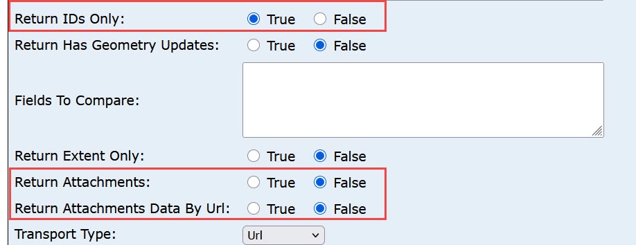

Hi - from your notes above it seems like the key issue is with the extractChanges url that is provided with the webhook and that returning an error. To help troubleshoot that, let's try the following - can you take the URL and run it from the browser in the REST services directory ?  Please set the serverGens to the values provided with the webhook URL. Then set returnIdsOnly=true as well as setting returnAttachments=false and returnAttachmentsDataByUrl=false - see attached image. Then run it..
This will run it as a synchronous process vs and async process which may return easier to interpret info. Let me know if this succeed and returns the expected results. If it errors please include the server log error messages.

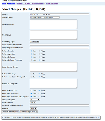

geovolve
As an update to this, we've discovered that Server Gens (without Layer Server Gens) actually worked also, we just had to pass through all layer ids as per the image below:
