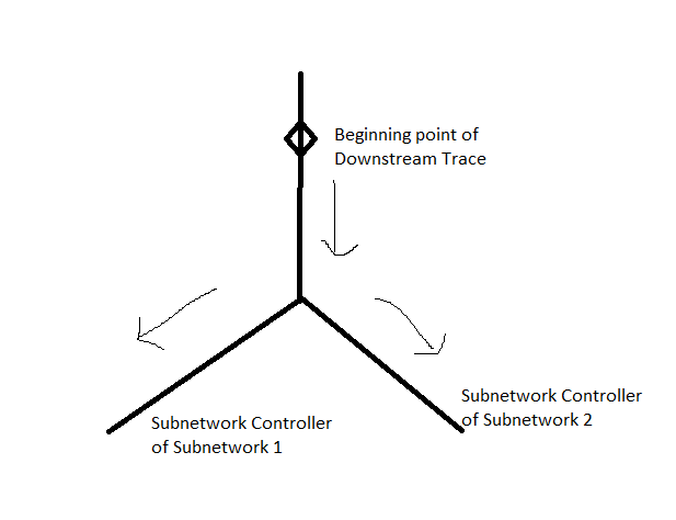

Hello, I have a utility network that models flow into sinks, and my use case scenario is one where the flow into two subnetwork controllers is expected (i.e there is not just one sink but there are two) and when we perform a trace, we would like the trace to highlight paths into both controllers.
I'll use the image below to illustrate this.
As seen above, there are cases where we would like the trace to flow into both subnetwork controllers and both paths should be highlighted when performing tracing. However, when we perform a trace, the trace fails as there are multiple subnetwork controllers detected.
Are there any solutions for the trace to work in this way?

If they are controllers of the same subnetwork, it should not be an issue.  I am assuming you made them controllers of different subnetworks?
GaneshPremakumar
Yes, we want them to be part of separate subnetworks.

@GaneshPremakumar if the two subnetworks are different, then they cannot be connected to each other. You'll need to find out why they are connected and correct your data so they are no longer connected. In the case of a gravity-based systems you may need to set up directional manhole channels or identify which pipes are only used in overflow scenarios.
In the above scenario the manhole where the flow diverges needs to be a directional manhole channel that defines which pipes are upstream, downstream, and which pipes have mutually exclusive flow. I discuss some techniques for troubleshooting tracing issues in gravity systems here: Stormwater Network Data Quality Assurance. The article is written for stormwater, but is readily applicable to most gravity systems.

GaneshPremakumar
Hi Patrick, how would these enable us to allow flow into two different subnetworks (the inverse Y Junction as seen in our diagram)?. In our use case, our subnetwork controllers do have multiple terminals, and the valid paths have been defined as well. Thanks!
RobertKrisher
@GaneshPremakumar the subnetwork controllers stay as is, but the manhole where these two subnetworks comes together will have this terminal configuration. The path for each subnetwork will be assigned to a different downstream terminal and you will use the "up to down" terminal path. This lets the system know that subnetworks 1 and 2 represent mutually exclusive downstream paths in the network (which fixes the inconsistent subnetwork name error) while still allowing the area upstream of the manhole to belong to both subnetworks.
